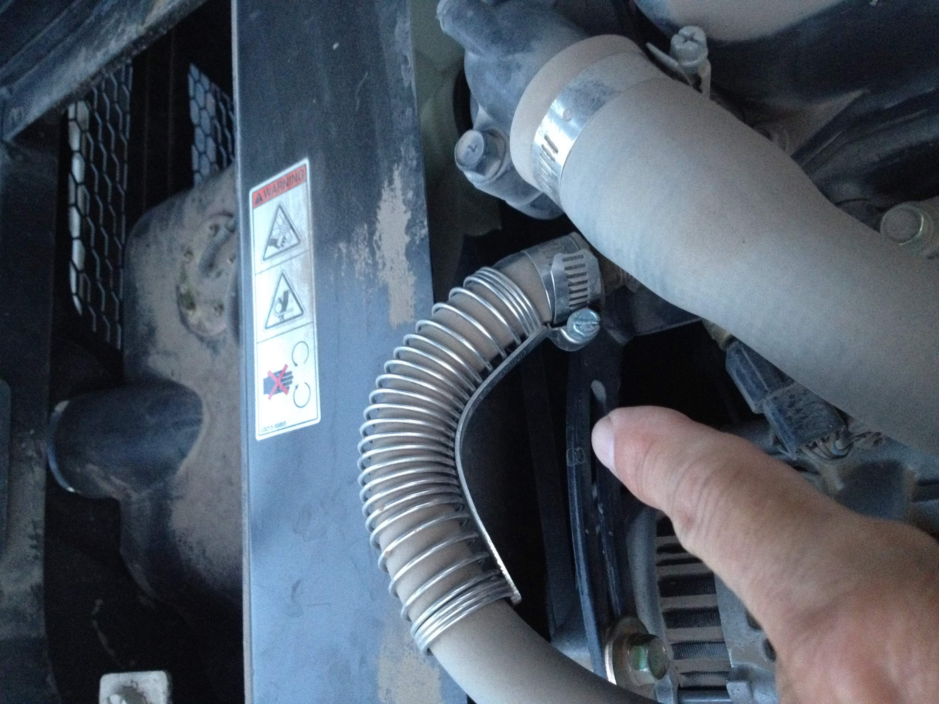

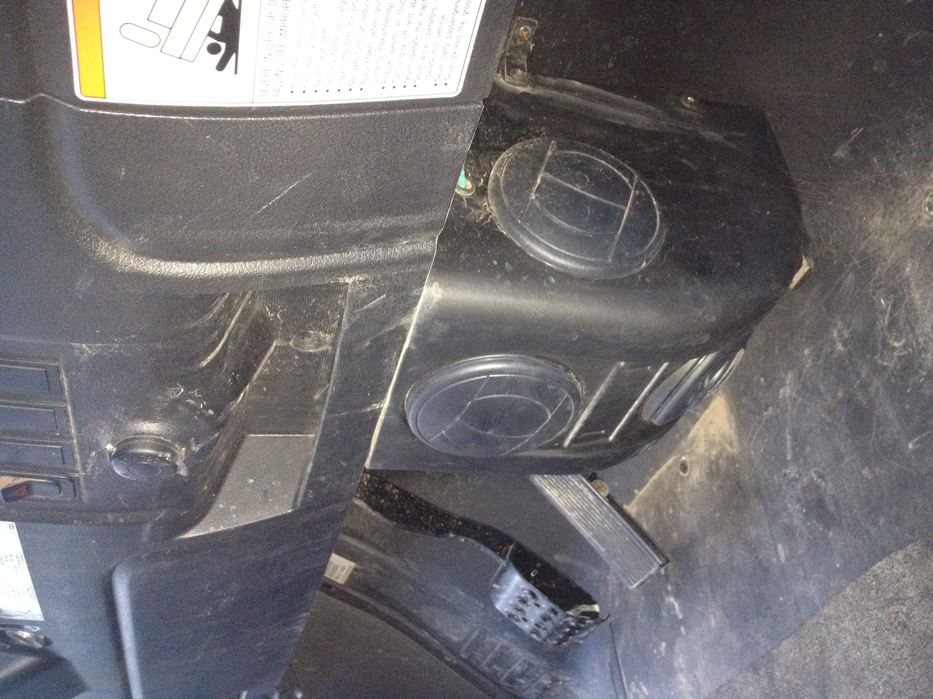

i bought a universal type heater and i place it under the dash with a piece of strap holding it up ( under the hood is where i supported it ) i will get some pics as soon as i get back to ranch . It really looks factory and works pretty well . I used the line to the cig lighter for power. It has a 2 speed fan and is not obtrusive to the middle seat passenger. It suggested a simple t fitting into the radiator hoses, however I placed a t at the engine bypass outlet in order to get faster warmup. The pics will explain much more clearly.

utv parts and accessories dot com, i purchased the universal heater for around 250.00. I have a few pis=cs but cannot figure out how to upload.
