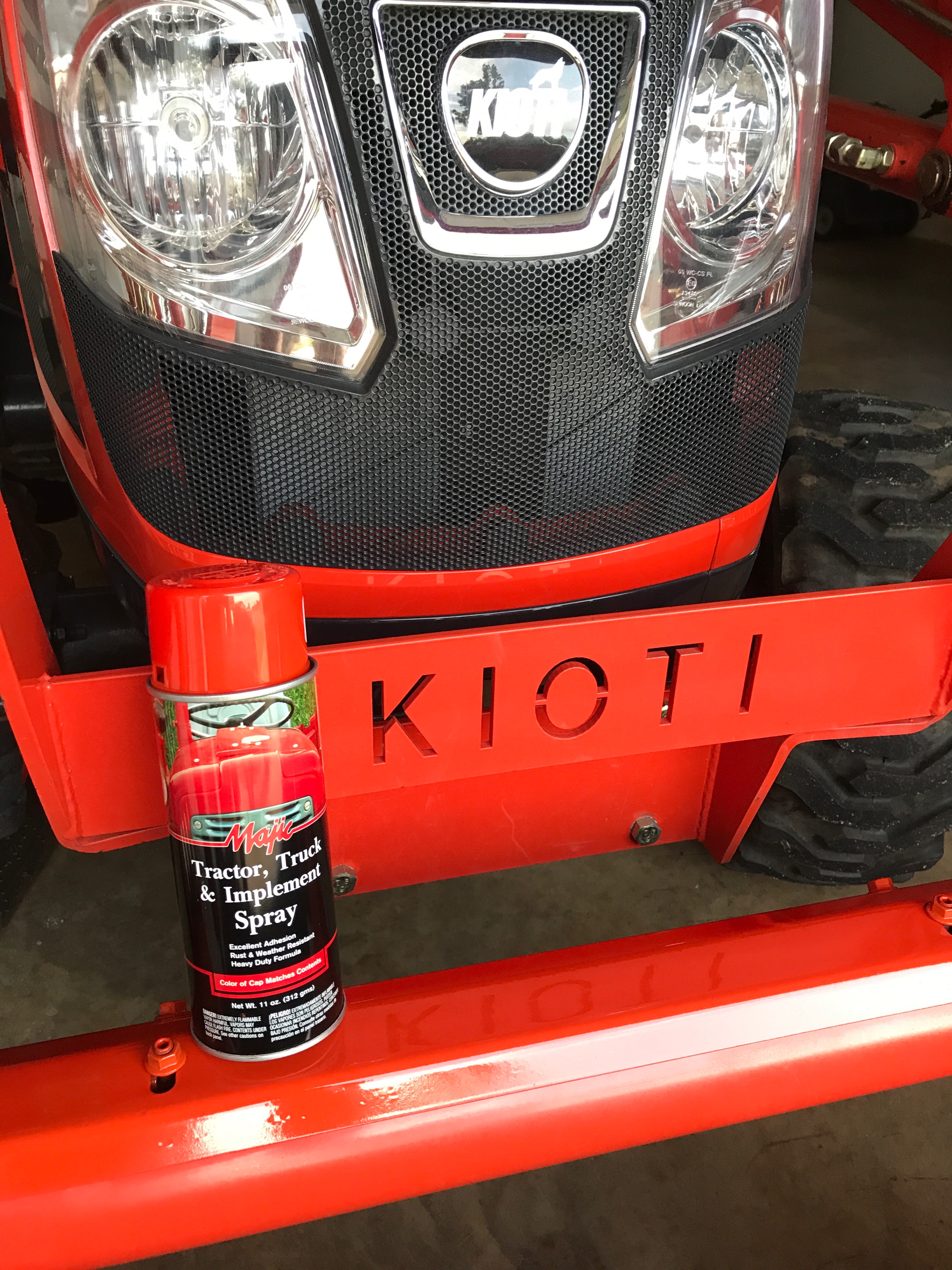

I have a question, and probably one that's been asked many times on here, I am sure, but is the Kubota orange paint the same as kioti orange, and is there another gray that matches the bucket. The price for paint the dealer wants is crazy, tractor supply doesn't sell anything for kioti
   / Kioti paint #2
   / Kioti paint #5
+ 1 for the Chevy orange ( High temp. engine) . I needed to do some touch up on the 04 CK30 found the factory can we had from new . Good thing I did a test spray because the color had turned brown !
   / Kioti paint #6
+1 on Chevy engine orange/red. I used it on my 2006 DK45s loader cross-pipe guard (that covers the hydraulic lines) after some welding. The only difference I could see was the new paint was more shiny.
   / Kioti paint #7
My Dealer has Kioti Orange paint. Hess Farm Equipment Canton, Pa. 570-673-5143.
   / Kioti paint #8
Dealers have Kioti orange but as said above the Chevy engine orange/red is a MUCH cheaper option and looks exact match and found in any automotive store.
   / Kioti paint #9
+1 on Tractor Supply for the orange and my dealer having it also.
Pretty sure I've read in other posts in the forum that no one has found a gray to match the ROPS. Is that still a true statement or has someone found something close?
   / Kioti paint #10
I used RAL 7021 Black Gray on my skid plate and it is almost an exact match. You can get it mixed at most auto paint shops.
