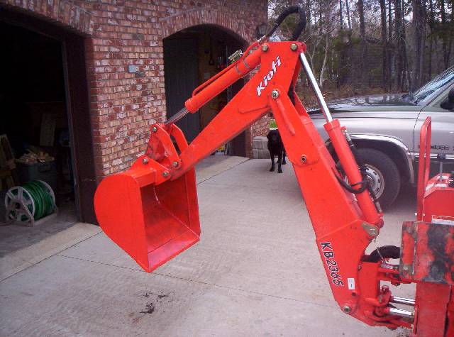

I used a brand called Duplicolor Chevrolet Orange DE1620. This is my backhoe bucket I got made for a dozen of beer. It is hard to tell the difference in color.
Steve
