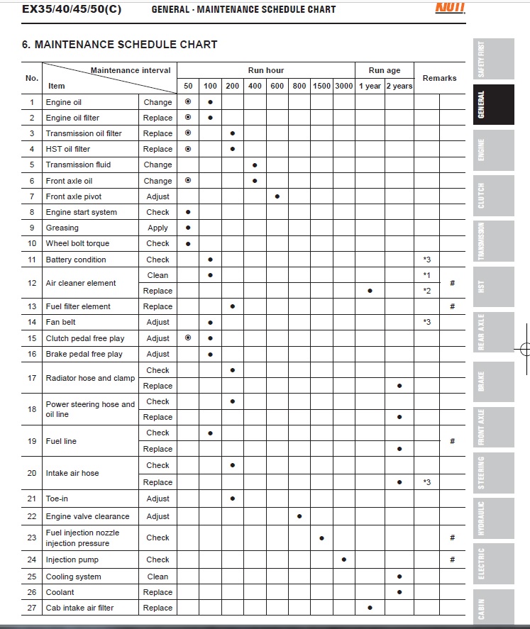

In case this is helpful to anyone, there was an error in a spreadsheet I used for the fuel filter, these are the filters that I purchased and installed in my tractor, so I know they fit, if nothing else.
Oil - 5.6Q, Rotella T6 5w-40 (Tractor Supply)
Oil Filter - E6201-32443
Air Filters (2, one outer, one inner, mine only had the outer filter from the factory, I put both in and it fit/works fine) - Wix 46489, Wix 49490
Fuel Filter - F6800-16411 (this part number was wrong on other spreadsheets, it's a large can style filter, looks like a big oil filter when you take it off with a hole in the bottom for the water sensor
Hydro filter 1 - Kioti T4620-38033
Hydro filter 2 - Donaldson P57348
Hydro Fluid - Traveller Universal Trans/Hydraulic (Tractor Supply)
Now, one thing, this was a 200 HR service, and the manual says to do the hydro filters and not the fluid. Which is what I did, but, I thought that was really strange, so, on 2nd reading, it looks like it says to "inspect" the hydro filters, not replace them at 200 hours (replace looks to be 400, and with the hydro fluid). I have absolutely no idea how one "inspects" a hydro filter, but I suspect that I changed these early and they really only need to be done every 400 hrs. If anyone knows for sure, please feel free to chime in.
Thank you for all the great instructions and info on this; I hope that this list is helpful to others contemplating their own service on the tractor. Took me about 2hrs start to finish to do it, I suspect next time I'll be down to 1hr or less now that I know where everything is and how to get it off/what tools I need. Pretty simple, good access to everything, no crazy/special tools required.

I think the donaldson hst filter is a P573481, you're just missing the 1 at the end there.
My Workshop manual for the EX45C (almost exact to the DKse series) says more clearly than our US owners manuals to change the hydro and HST filters at 200hrs. The NX may require different, but I thought it may be useful here.
Heres a screenshot of that page.

So you really are supposed to just do the filters and not the fluid? That's what I did, but, looking in my owners manual, I thought it said "check" instead of "replace" for the filters at 200 hours. Either way, it's kind of strange, when you pull the filters, you lose quite a bit of the hydro oil, so you need to fill'er back up when you finish (I think I lost about a gallon). Just never done a service like that before, good to know it appears to be the right way.
And yes, you are correct, the right part number is:
P573481 for the Donaldson hydro filter. Updating the chart in case anyone is following this or needs this info in the future:

Is there any real reason NOT to change the hydro fluid when changing the filters besides cost? I'm at my 50-hour service and I happened to be at Tractor Supply when they were selling 5-gallon pails of Traveller hydro fluid for $20 and at the time, I thought it was filters AND fluid at 50 hours so I picked up 3 pails. After reinterpreting the owners manual, I realized that it ONLY calls for filters at 50-hours but I was going to change it out anyway since I already have the fluid and will need to change the filters anyway.
Also, I noticed the tier3 NX guidelines call for engine oil and filter at 50 hours, then yearly after that. For tier4, they only call for engine oil and filter every 200 hours! I really can't imagine leaving the initial engine oil in for 200 hours, which will probably take me over 2 years to get to. I also want to do this in order to switch to synthetic since I'm in a cold weather territory.
So, I was planning on doing a full service at 50-hours: axle lube change, engine oil and filter, and hydro fluid and filterS, even despite the owner's manual not specifying it as all required. I actually already have all these materials (besides the 2 HST filters which I was just going to get from the dealer) already since I picked up everything as I saw it on-sale at different places. My take on it is that as long as it's done right, it can never hurt to change fluid.

I changed out the hyd. fluid at the 50 hour service on the CK. It was dark gray and lots of machine fines drained out as well. So by changing early and then at 400 hours you in pretty good shape.
Tier 4 guidelines for oils is something I also will skip and do an annual change out.
The axle fluid also changed out at the 50 hour service. After reading many posts here I used 85-140 gear lube non-synthetic for now. Will give it a good work out this year. Once all the initial wear in is done next summer will get 2 gallons of syn. gear lube.
