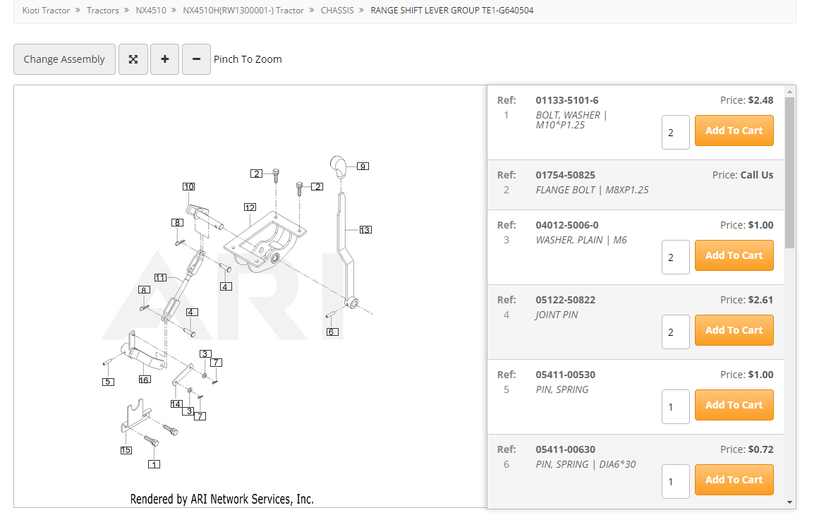

Hi folks, I am having issues with my NX4510HST range selector. It seems to need adjustment as its not switching at the right locations and I cant seem to reach high and low kicks in were medium should be. Does anyone have details on how to adjust the range selector or if this is a bigger issue? Thanks
   / KIOTI NX4510HST Gear selector #2
Looks like the linkage for the Range selector lever (#11) is adjustable, so it might worth starting there. Check Michigan Iron Equip for parts breakdown. Here is an example I took from them but I don't if it matches your tractor as they list different serial numbers.
   / KIOTI NX4510HST Gear selector #3
Pay particular attention to roll pins #5 and #6. Known problem areas.
