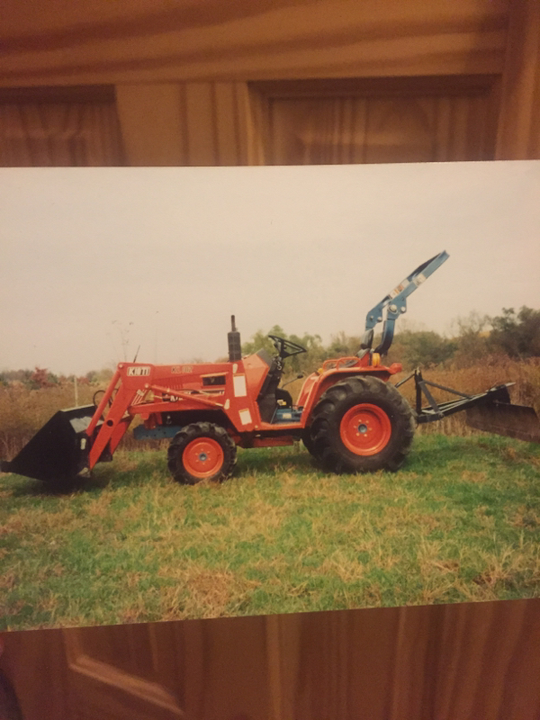

Honestly I can't remember it's been a good while since I had that tractor. Plus not all mowers have same power requirements and it will depend on conditions your cutting. I believe full rear discharge mowers generally use a bit less but blade speed and other factors have affect also.It won't be long before you have a good feel for it and you'll know where it likes to run
Here's a pic of mine
