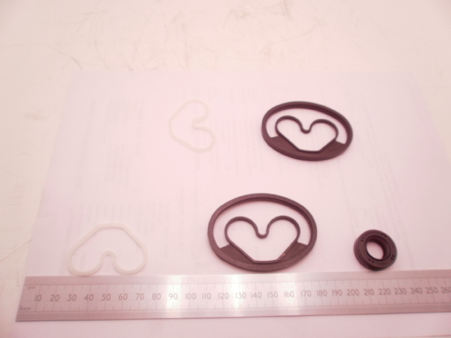

Already posted this in another forum and couldn't delete it but I figured I'd get better response here. Anyone know how to delete a post?
I've got a 1998 LK3054 that the fel was slow this morning, so i took the pump apart and it looks fine even though aluminum housing but there's a rubber seal inside that's broken. According to my local dealer there are no parts available for the pump, so they want me to replace the pump for a $5 piece of rubber. Does anyone know where i can get parts for the pump?
Thanks,
Jim

Original poster, I'd pull the seal out and see if you can match up to something. Get measurements from it if you can. Is it an o-ring?

   / Kioti LK3054 hydraulic pump rebuild
It's a goofy looking thing as shown below. Pump is made by Nihon Spindle and i think it's a RG2 series... found the following seals which i think will fit from Whitehouse Products LLC in the UK. I'll let you know if these are the correct seals.
Success!
For anyone else not interested in taking the kioti shaft, the seal kit is available from whitehouse products llc in the uk.
Part number: 5N2/39801NISA01 SEAL KIT TO SUIT PAA66RD268
