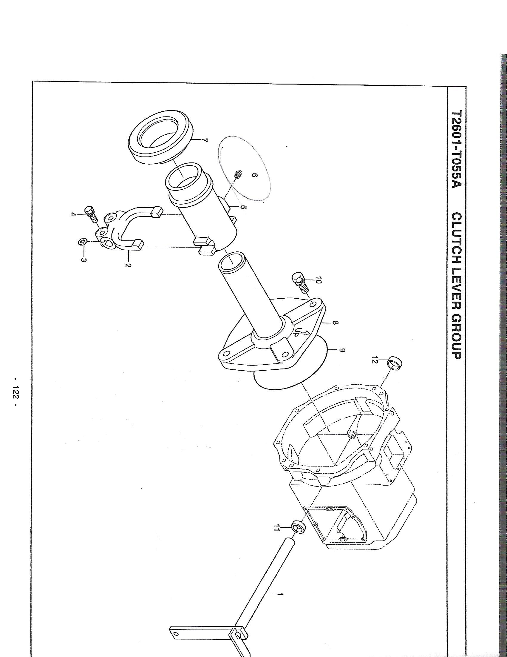

Not sure about your "30", but the earlier 3054 which is the same tractor except for the engine, has a grease fitting on the throwout bearing carrier inside the clutch housing. It's located behind a removable plate on the right side of the housing. If your unit has this provision, just one pump, then work the clutch so as to distribute the grease along the shaft. If it's still sticky, give it another pump I would suggest no more than two pumps; you don't need grease all over your clutch plates
   / Kioti LK30 "sticky" clutch
Thanks for the information. I removed the inspection plate and I could see the bearing carrier. Unfortunately I cannot see the grease fitting. It is very hard to get a good look with the front loader frame that is a little in the way. I will try again with a better light and a small mirror. Do you know if the grease fitting is more at the back end of the carrier (towards the rear). If I can spot it I will try to get a good picture to post because it sounds like I am not the first one to have trouble locating this fitting.
   / Kioti LK30 "sticky" clutch #6
I found it easier to get to the fitting if you have someone depress the clutch untill the zerk appears in the "window" tbn.jpg
