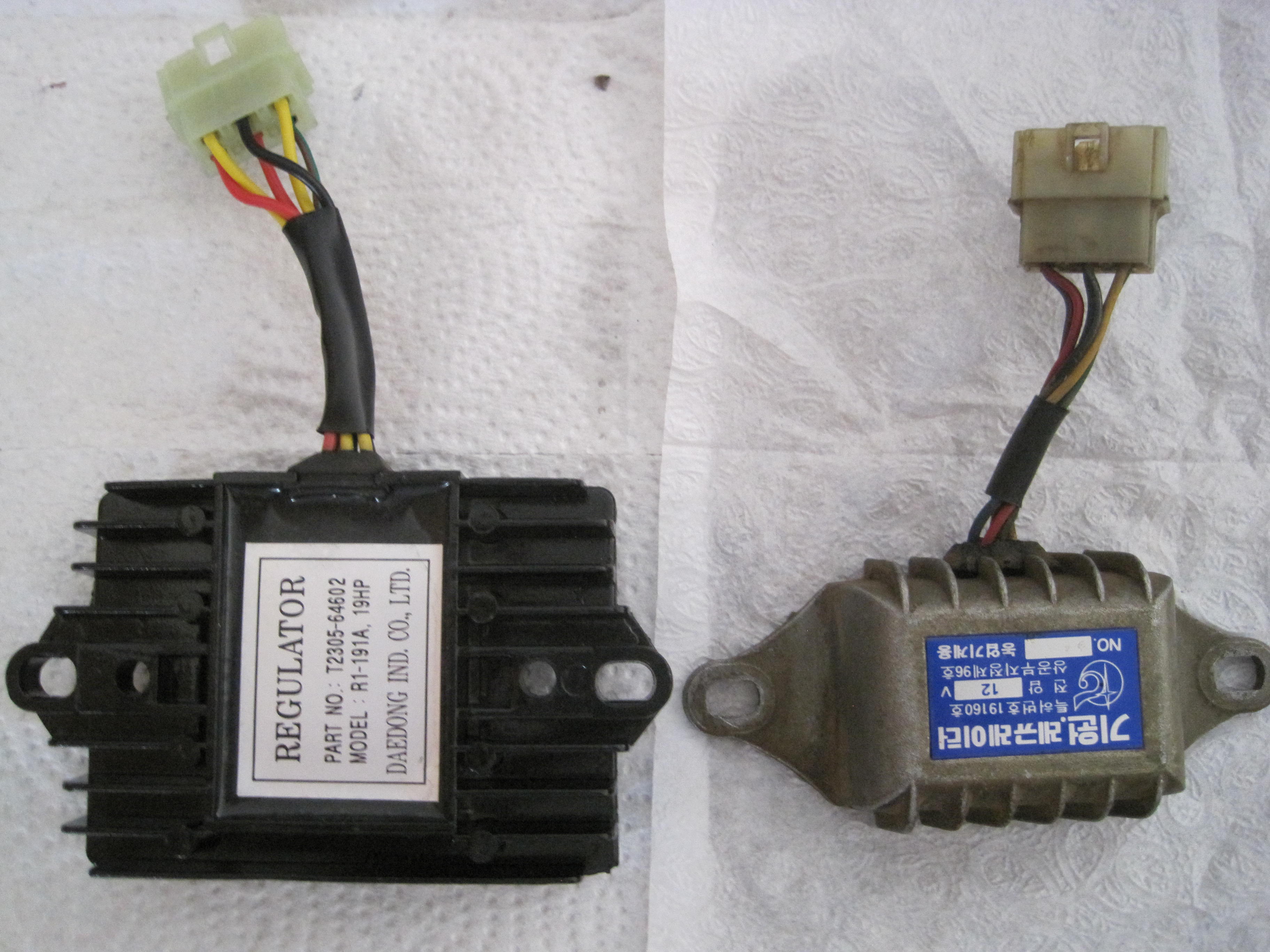

So I am having trouble with my charging system, found a bad battery replaced, bad alternator replaced, regulator ordered new from Kioti after 6 weeks it arrived, not the same, wire colors don't match, and won't bolt up to the firewall without removing other parts, but has the same plug end, any ideas?

I just put one on my LK2554. I got one for a 1970 Toyota truck. Same plug and bolted the same no problem.

Problem solved, I went back to my Kioti dealer and he called the company directly and explained that the only regulator they have on there order site does not fit the older model Lb1914, and to my surprise the company had one older style regulator in the back that was half the price of the new version that they advertise as the only option. So after a new battery a rebuilt alternator and a new regulator I'am back up and running after 2 1/2 months of down time.
