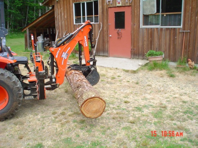

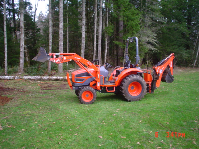

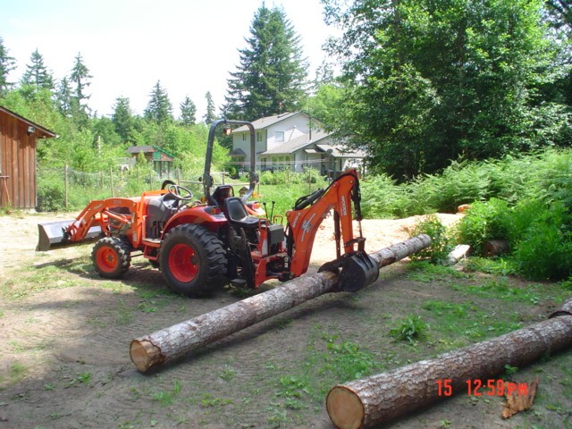

Here are some pictures. I have a 2008 CK35 HST with the Woods BH-70X backhoe. Must say the thumb is very useful. The tractor came with the backhoe on it and took me a few months to get to the point of taking it off. Have had it on and off probably 15 times now. Only a couple of times did it take longer than about 10 minutes, once took me about 30 minutes, guess I was having a bad day. Going to use the backhoe today at the neighbors to dig out a couple of trees. Nice sunny day today :) but looking wet :( for the next few.
