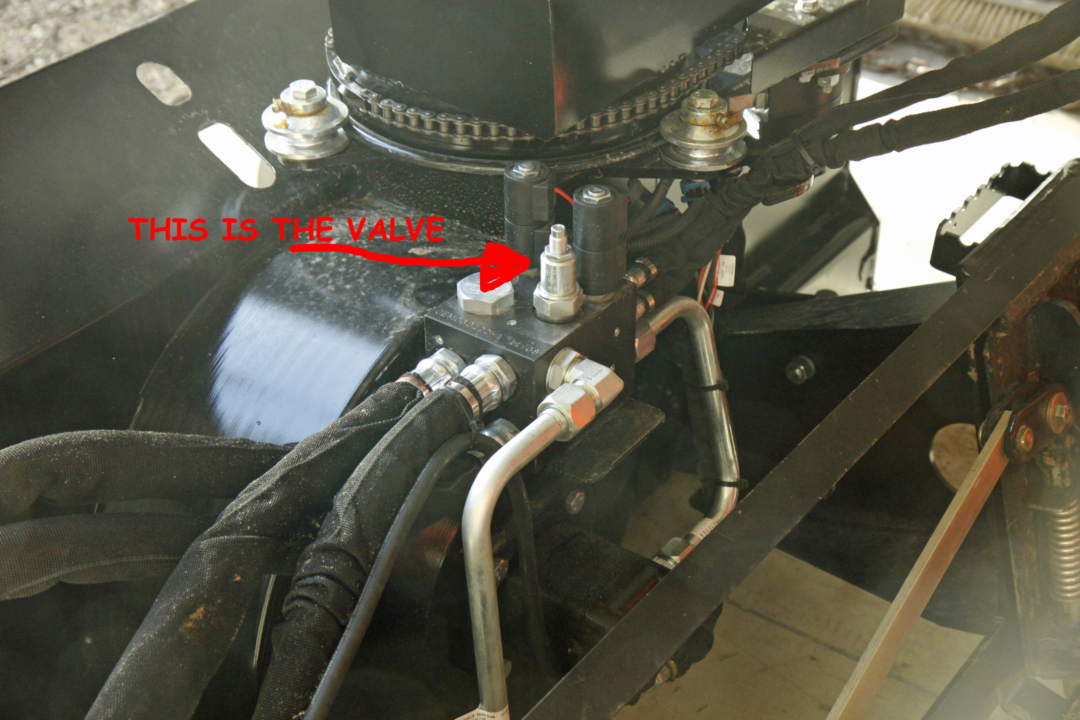

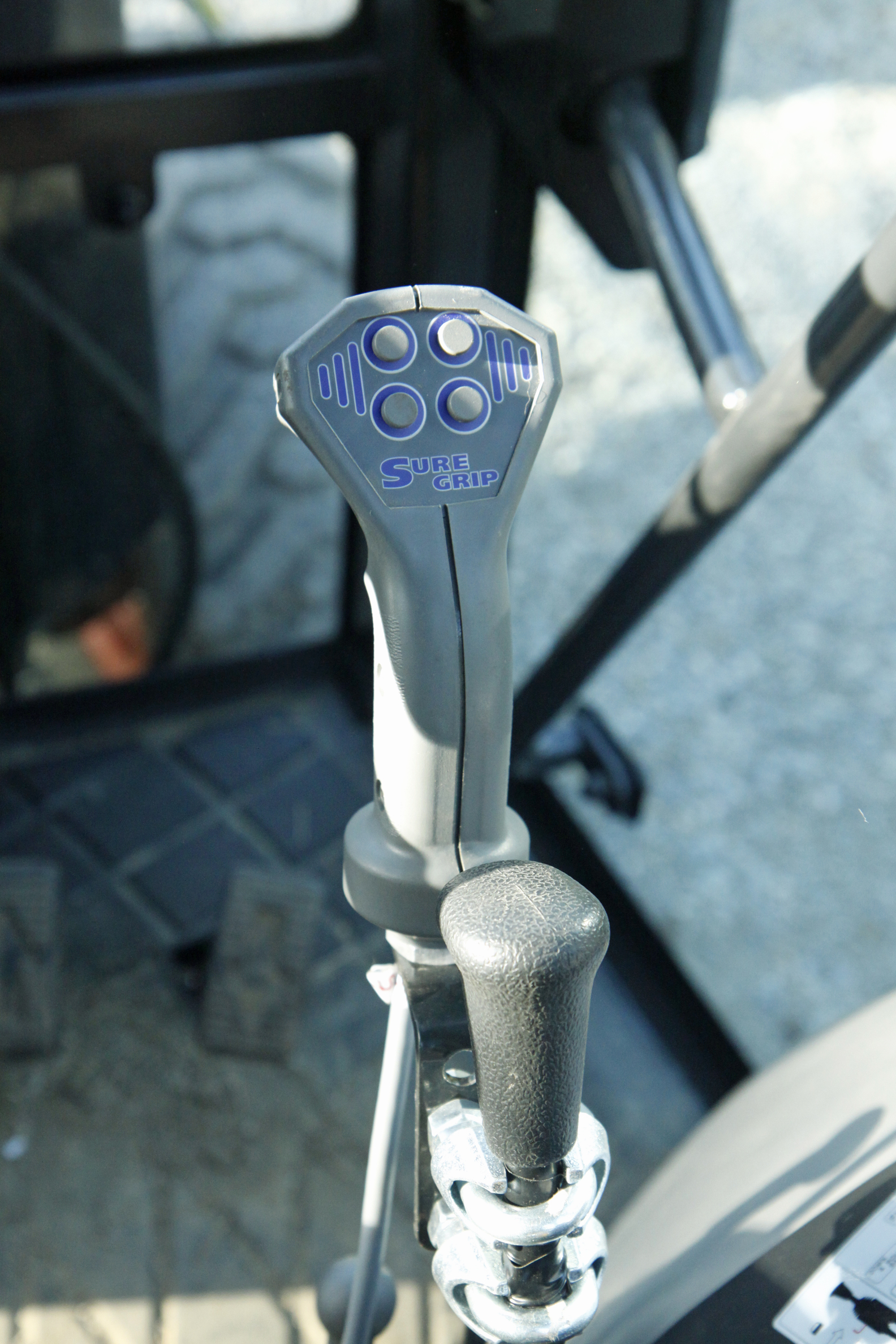

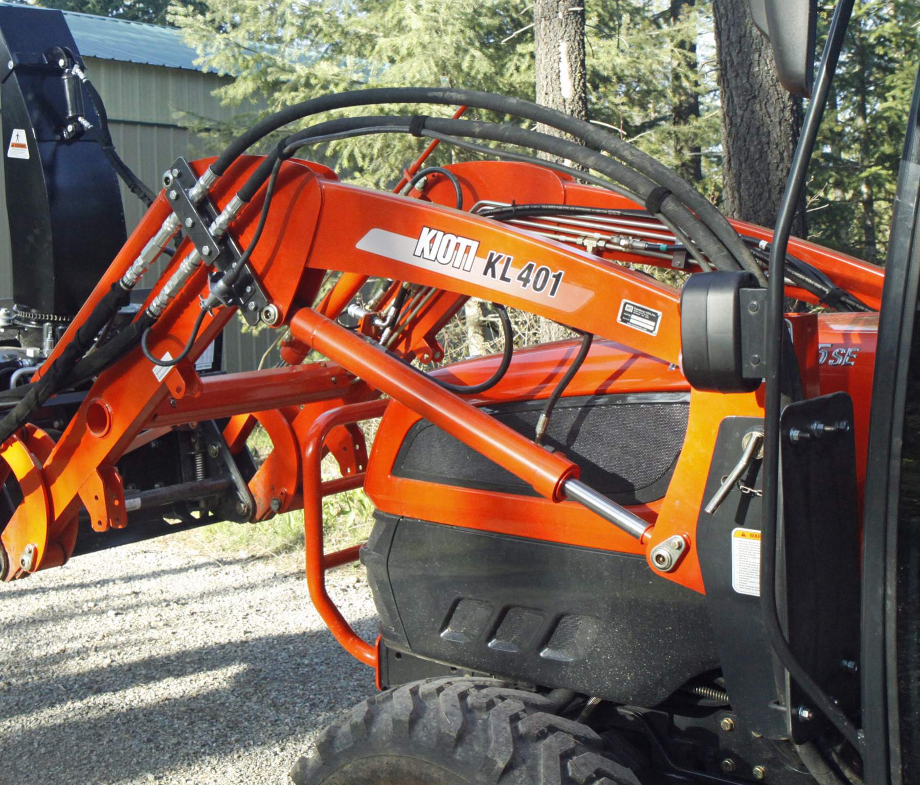

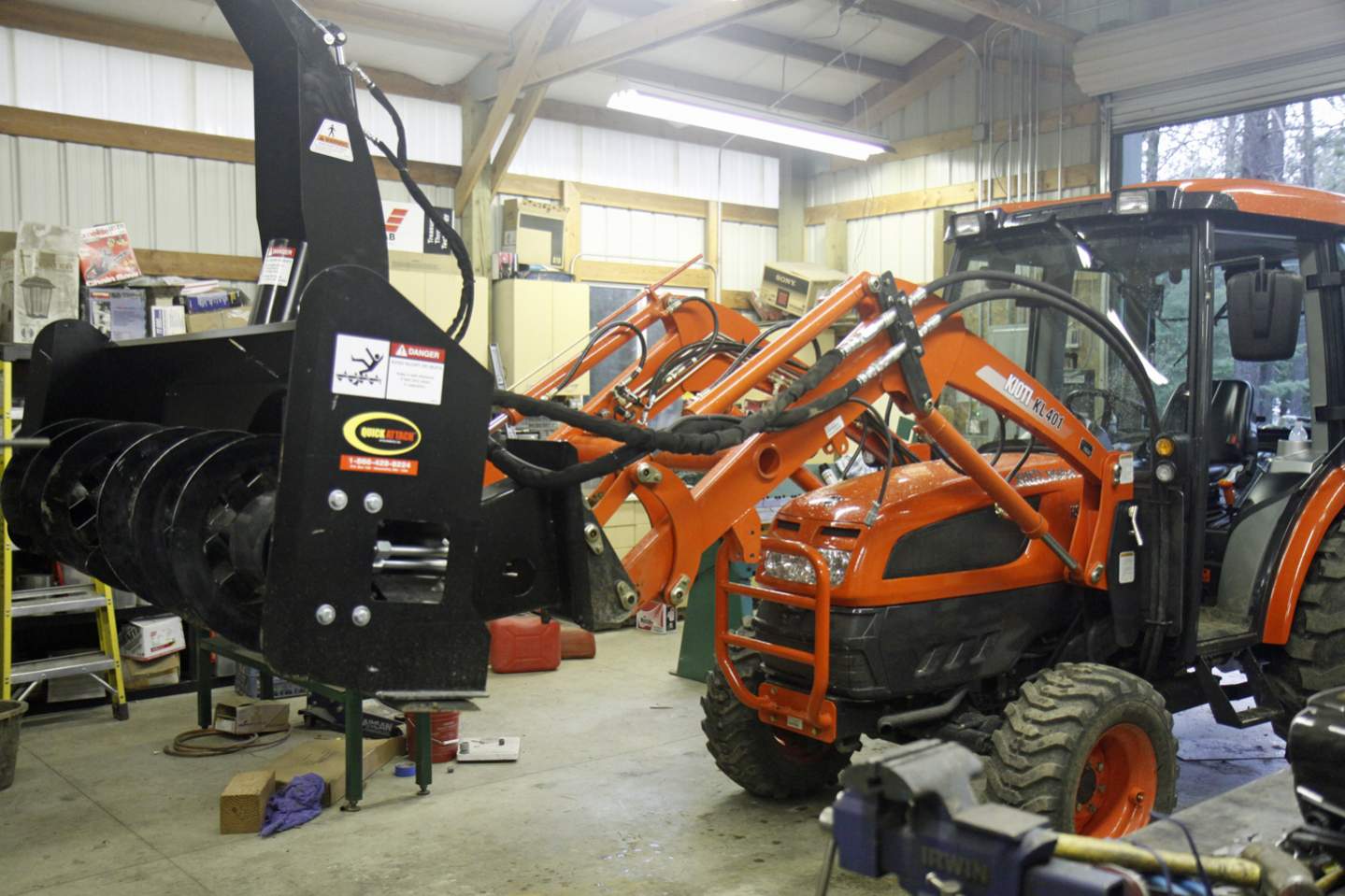

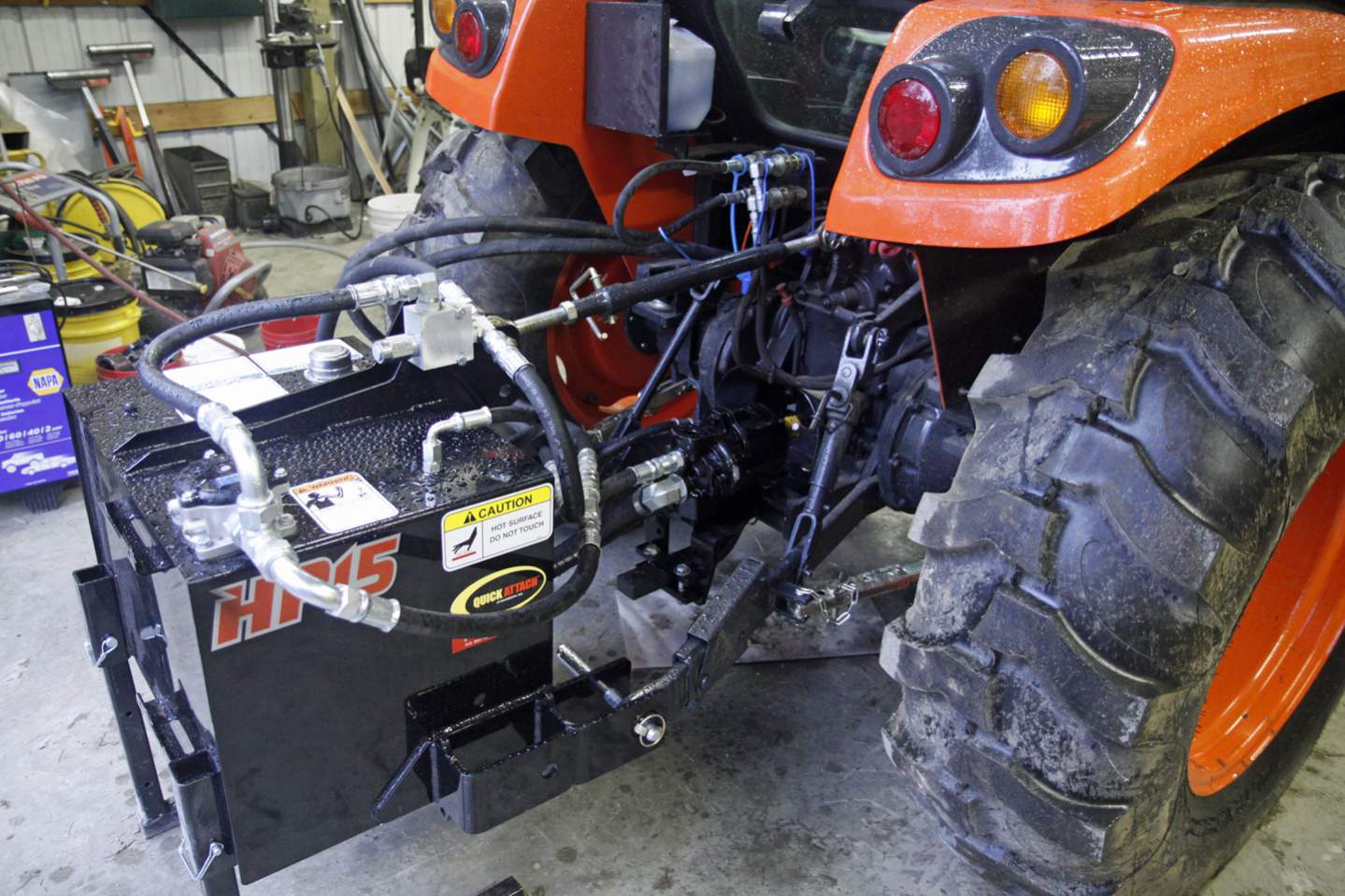

i have the similar hydraulic powerpack unit powering my front snowblower. rotator is hydraulic, same joystick controller. but theres alot to the plumbing for these things. i can see why they go electric. personally i prefer the hydraulic.This is the rotator assembly and pressure relief valve (NO SHEAR PINS)rotator  text.jpg good controller view.jpg side bracket 1 and 2.jpg snowblower installed.jpg powerpack 1.jpg

i have the similar hydraulic powerpack unit powering my front snowblower. rotator is hydraulic, same joystick controller. but theres alot to the plumbing for these things. i can see why they go electric. personally i prefer the hydraulic.This is the rotator assembly and pressure relief valve (NO SHEAR PINS)View attachment 625242 View attachment 625243 View attachment 625239 View attachment 625240 View attachment 625241
The CK's are far less complicated, I lose the FEL, attach the sub-frame then the snowblower - the hydraulics use the FEL for lift and rotation, with the SE I have the rear valves so I can run chute lines to it, costly with the length of line but less then the cost of the front valve install - Your's is a nice unit, like the fact you keep the FEL.....
