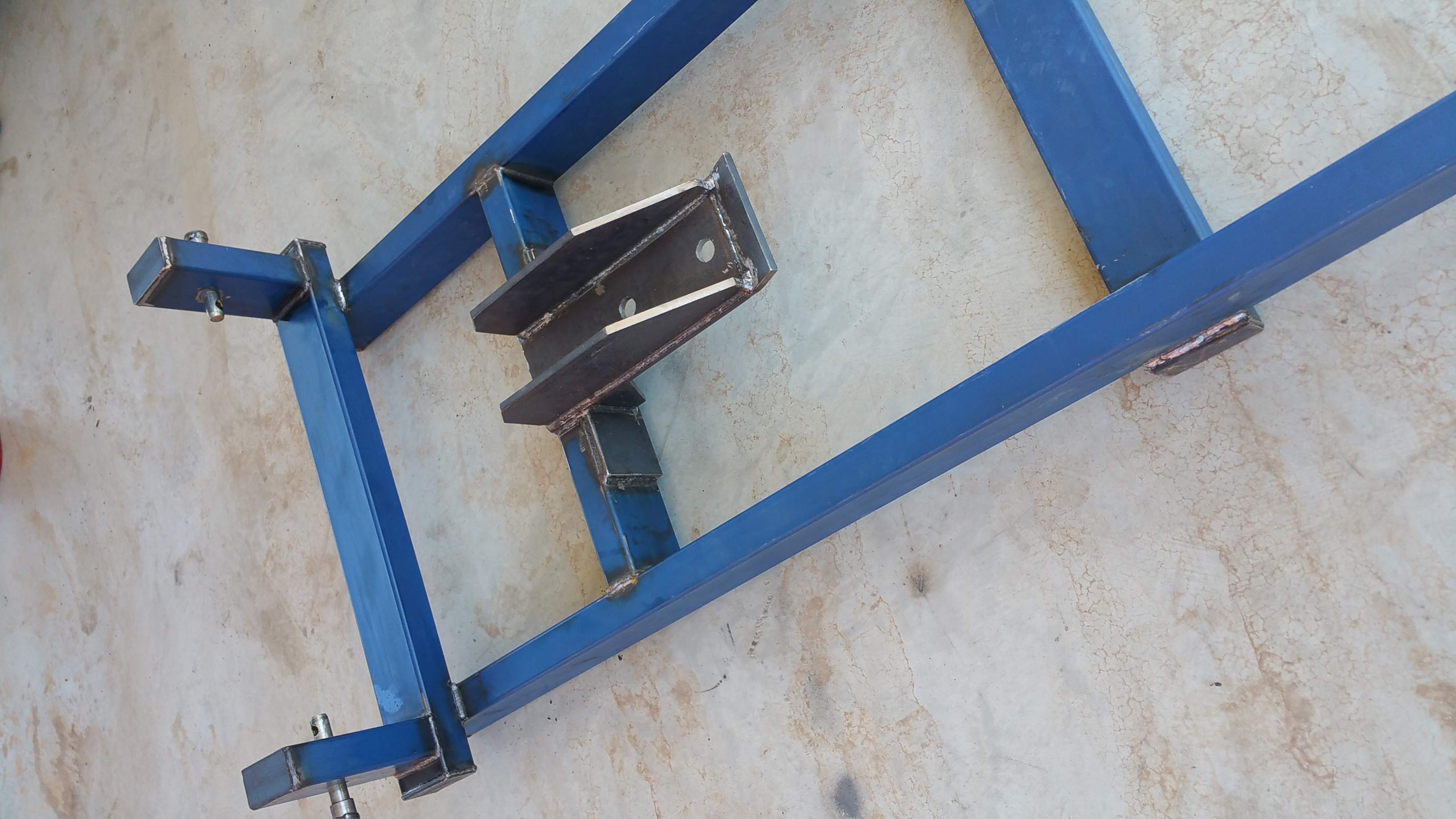

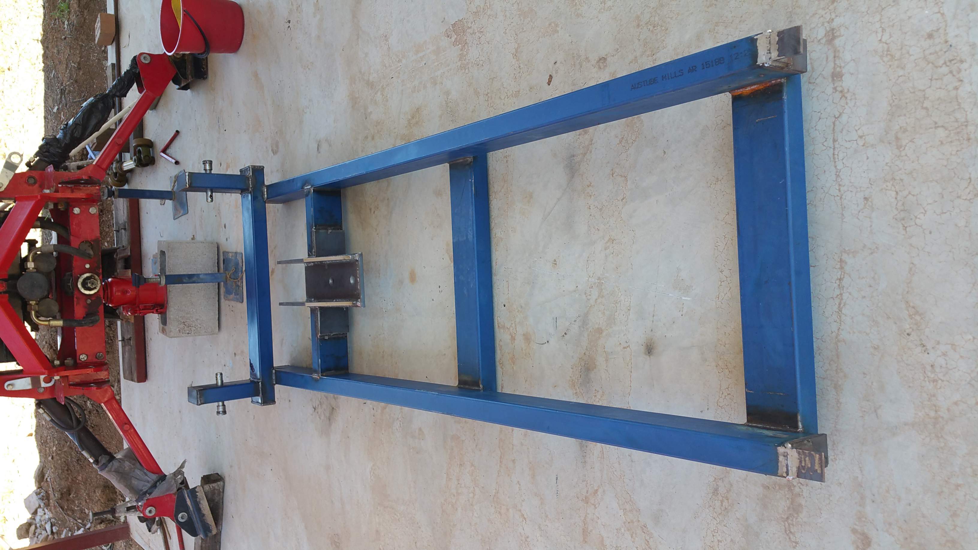

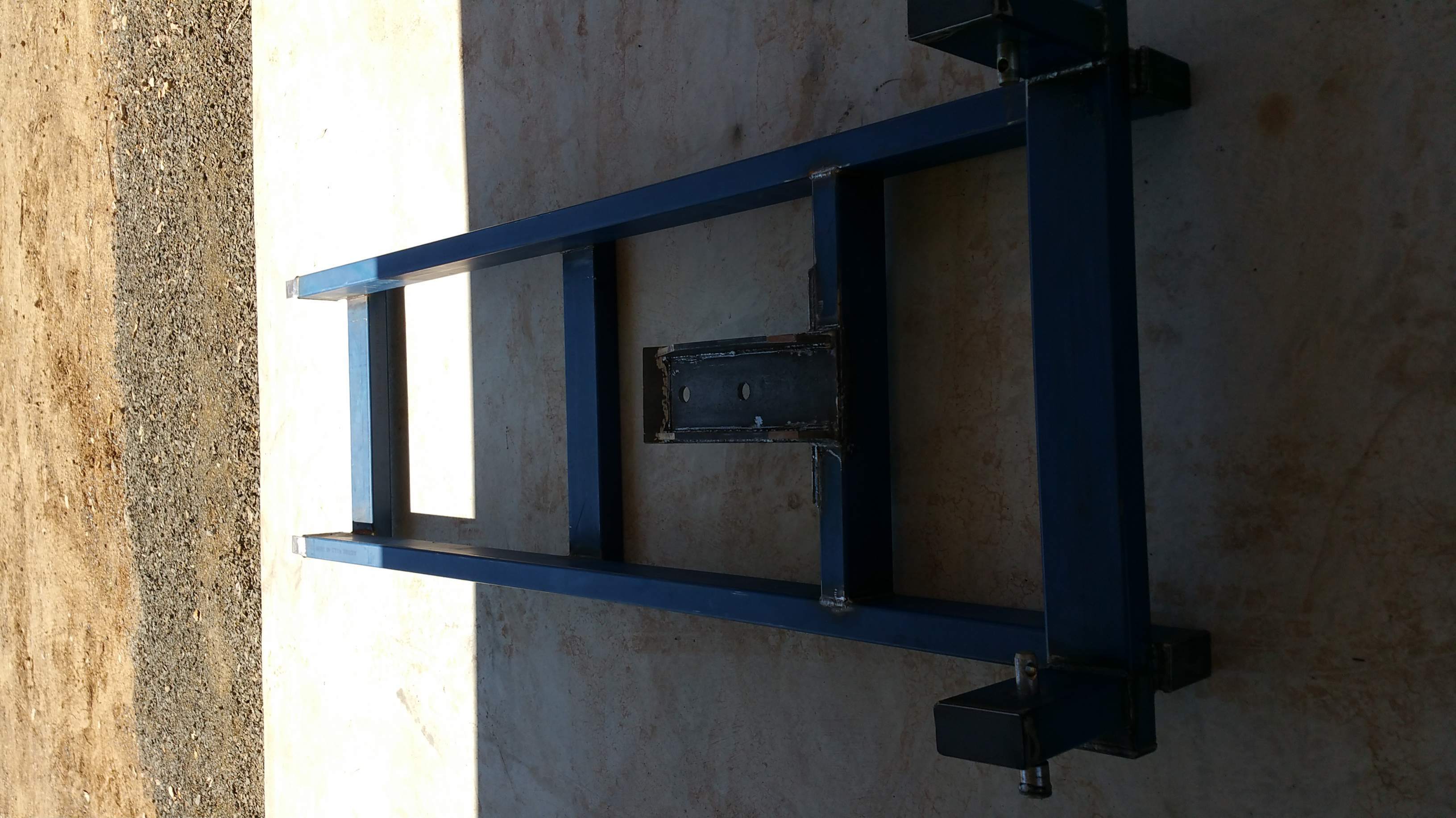

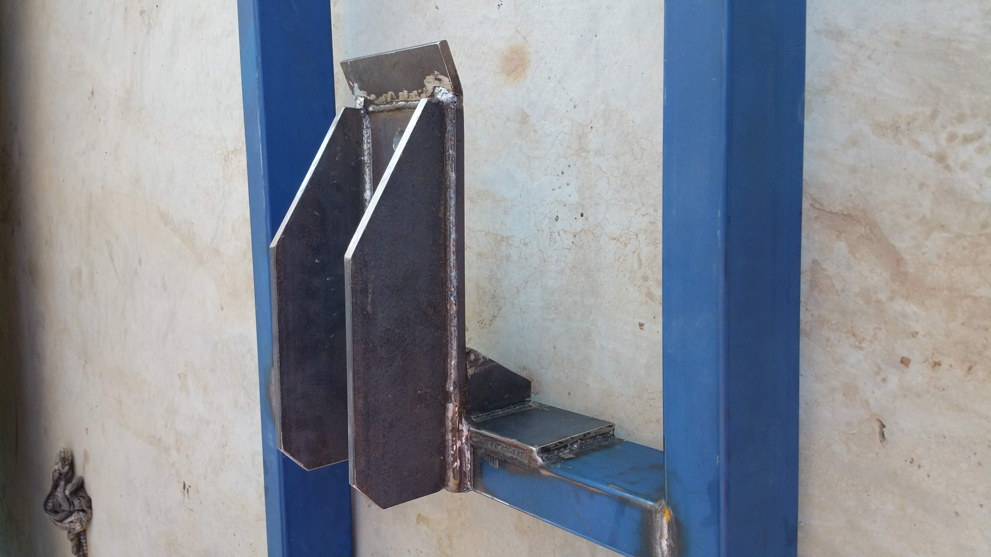

After looking at Island Tractors pics of his subframe a couple of weeks ago I got to grips and attempted to get mine made.I constructed it out of 100mm x 50mm box steel for the main frame and 150mm x 10mm for the rear attachment under the pto.I do not have the large receiving plate under the pto and have had no luck with the Kioti dealers here in Brisbane so i have had use what I have which is the attachment which houses or accomadates the towing bar.You will see that I have had to put the front and middle cross members under the two rails ,unlike the rear member which is inside the two rails, this had to be done so that I am able to slide the rails all the way in from the rear of the tractor because the backhoe that I am using has its own pump and therefore needs the pto shaft connected before i can lift up the subframe.Hopefully the pics will upload ok as i have never done this before and am only using a phone and not a computer so heres hoping .
