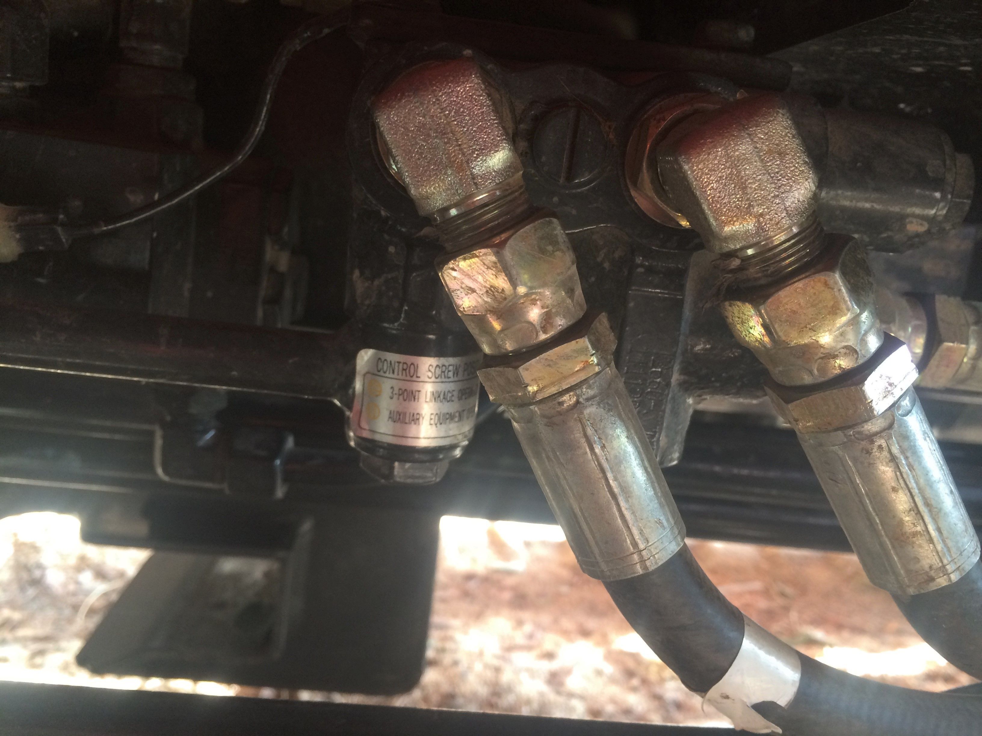

Greetings to all!!
I need to add a control for a grapple on my FEL. I've read as many posts on the subject as I can and I understand the principles behind all the options, be it another spool valve in series after the FEL control using PB, 12 VDC/manual diverter valves or additional rear remote kit. I did not find an answer to address my specific situation however.
My tractor has a hydraulic block/manifold that services the FEL spool valve as well as a set of rear remotes and the 3 PTH. From all the posts I've read on the subject, I've concluded that if I wish to add another spool valve to control the grapple, it needs to be plumbed in "after" the hydraulic block to it's intake port then out it's power beyond port back to the line to the rear remotes....in other words between the block and the rear remote valve. I have included a picture of the hydraulic block on the tractor. As you can see, the line going aft to the rear remote valve is steel and not rubber ( the one with the silver sticker on it). My question is: how do I plumb a new line in to divert the flow to the new valve?...does the steel line need to be cut/flanged or as I am hoping, is there another way to tap into it with a new fitting/block? Given that there is likely very little flexibility, what would my options be? Any opinions or ideas are welcome. Thank you!

Do you want a true 3rd function or a diverter valve.
A diverter valve will install in the loader curl circuit and controlled by a switch on the loader handle.
A true 3rd function valve can be installed anywhere inline/series flow path. Switch on handle.
You could install the 3rd function valve just after the loader using the loader PB to feed the grapple valve, and the graple valve will feed the hyd blk.
Tank lines go to tank.

Thanks for your quick reply JJ....I have been trying to decide whether I should go with a diverter valve off the loader circuit or true 3rd function....I was under the impression that I had to install the grapple valve after the hydraulic block....you've answered my question though...I can insert the grapple valve in series between the FEL valve and hyd-block...not sure what you mean by "switch on handle" for true 3rd function valve though....now I just need to figure out how to tap into the tank line which is also a rigid steel line from the hyd block, if I decide to go that route......thanks again.

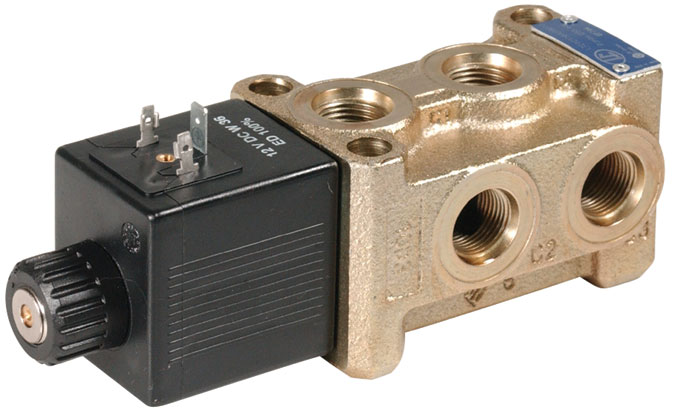

   / Kioti DS4510-adding 3rd function spool valve after hydraulic block. #4
The switch on the loader lever handle, activates the valve that you install.
It can be momentary push button or on/off switch.
There is a default mode using the diverter, and that would be with no voltage, the loader would bei curl. Press the button to use grapple.
Something to consider when using the 3rd function, and that is if you use full lever on the loader, you will have no flow to the 4rd valve.
In order to use both loader and grapple, use only half lever so the 3rd function will have flow..

If all 3 of the rubber lines goes to the loader valve, one of them should be a tank line.

Leejohn...thanks for the info...the manual indicates the left rubber line is "in" from FEL control valve, the right rubber line is "out" to control valve and the other rubber line behind the right one is "return" from the control valve....that "return" line is the tank line...correct?
I also have another question....my total pump capacity for the tractor is 13.2 GPM's......so if I decide to go true 3rd function, I should chose a one spool valve with at least 13 GPM, correct?...or can I go with less GPM's than the total pump capacity on the tractor?

Tank line you are right. The valve should match your gpm, if you go bigger you feathering well be less, but well not do any damage. If you go smaller and it is just for a grabber it well move slower, but with a lot of use at one time it well build heat. I use 1/4" lines for my gabber, it helps with the speed and makes it just right for me and helps with the running of the hoses.

   / Kioti DS4510-adding 3rd function spool valve after hydraulic block. #10
Do you feel secure in using two lever valves at the same time with same hand?
For that same reason, most people shy away from another lever, where as the 12 v valve is operated by a push button on the loader handle.
The solenoid valve is probably less expensive also.
They will all work, be it a diverter valve, 3rd function solenoid valve.or a manual lever valve.
You can feather a lever valve, but not the 3rd function solenoid valve.
