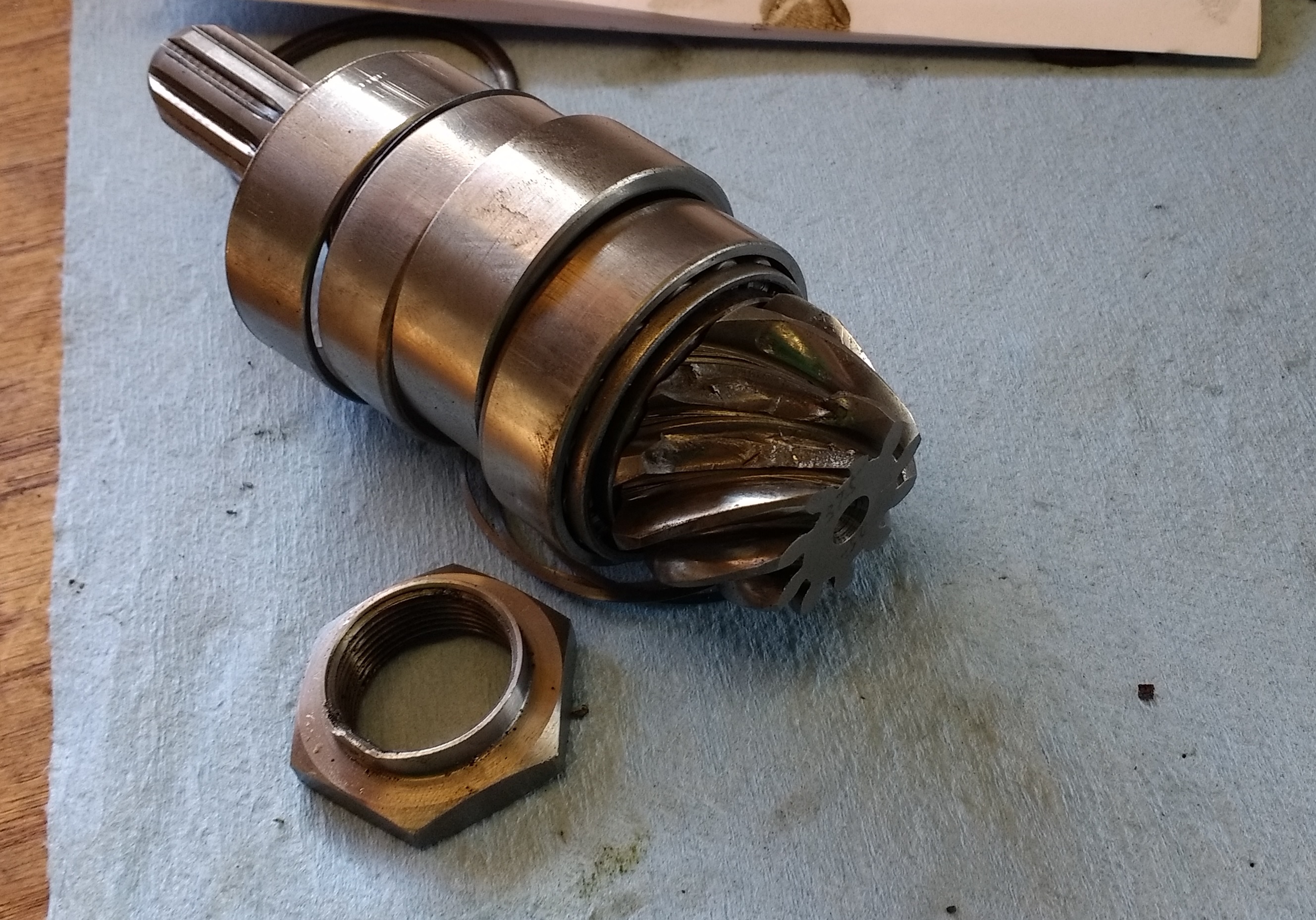

Hello out there. I am new to this forum. I found this site trying to figure out my issue on my tractor any help would be greatly appreciated. front end locks up in two wheel drive and when you put in in four wheel drive it has a slip and a popping noise. I'm thinking I've sheared teeth i have found a good source for a parts break down
link at the bottom but i am looking for a service manual for at least the front differential any help or ideas are greatly appreciated thanks

Had a similar issue on my dk45sehst, front end had to be rebuilt. It actually locked up and I had to use the bucket to get the tractor to move forward (sliding it on the ground). I think it wound up costing me 1300 at the dealership. If I remember correctly, they rebult the one side then the next year the other side went. Happened with 4wd engaged. FOr reference only, I think I have about 800-900 hours on it. I am now working on replacing the vinyl on my seat, as it has all cracked this winter. Hooray.
I can't recall what he told me, but something about how the front end is built they have to split it or something. I do some of the maintenance and repairs myself, but I left this one to them.

One thing that can cause this is pulling something very substantial in reverse with 4wd engaged. With front wheel assist tractors (front tires smaller than the back the front end is not robust enough to handle all the torque the tractor can put out and things in the front end will break. Especially if your trying to pull out another stuck tractor or a large tree always try to pull in forward with what ever it is hooked to the back, never to the front pulling in reverse. If you have to pull in reverse disengage the 4wd.

I don't follow your logic at all, the only way you'd overload the front axle would be trying to lift and curl your bucket while trying to pull backwards on a high traction surface.
Unless you are mashing the front tires down on a good traction the tires will spin out.

I think what he is talking about here is the spiral bevel gear, and the bevel pinion gear (ring and pinion) of the front axle,which have teeth that are far more robust when working in the fwd direction than in reverse due to the profile of the teeth.
I've seen this exact scenario play out before in a Massey 1533
Tacos issue could be coming from a number of places in the front axle and both axle bevel gear cases. Just have to dig in to find out.

The Branson 8050 does indeed have planetary reduction hubs, but I'm referring to the input drive to the front axle, which is still ring and pinion style. These types of ring and pinions do not handle reverse direction loads very well. Its the same for most cars/trucks/tractors etc. Good to keep in mind as a rule of thumb, be careful loading up and shock loading an axle machine in reverse, the ring and pinion gear teeth are not really designed for this.
