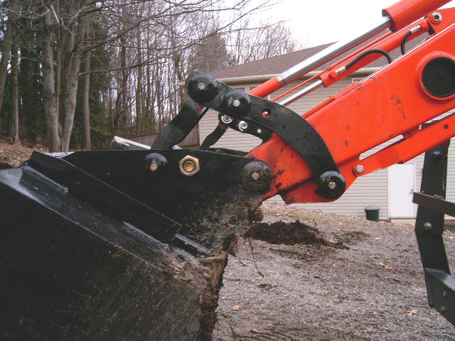

</font><font color="blue" class="small">( Keep away from the 1450 loader. It is weak in the roll back dept. )</font>
Bernard,
Did you ever move the bucket pins up a few inches ?
I think changing my linkage and moving the buckets pins up 3 inches helped. My roll back power seemed much better this year.

Bernard,
Drilling the quick attach, moving the pins and making the new linkage was a pain and takes a little time, but my roll back power seems much better now.

What he biggest problem is, our 1450's are about the only one with 1" pins. If they were bigger I could have ordered a NH [tach all} and it would have been solved. bcs
