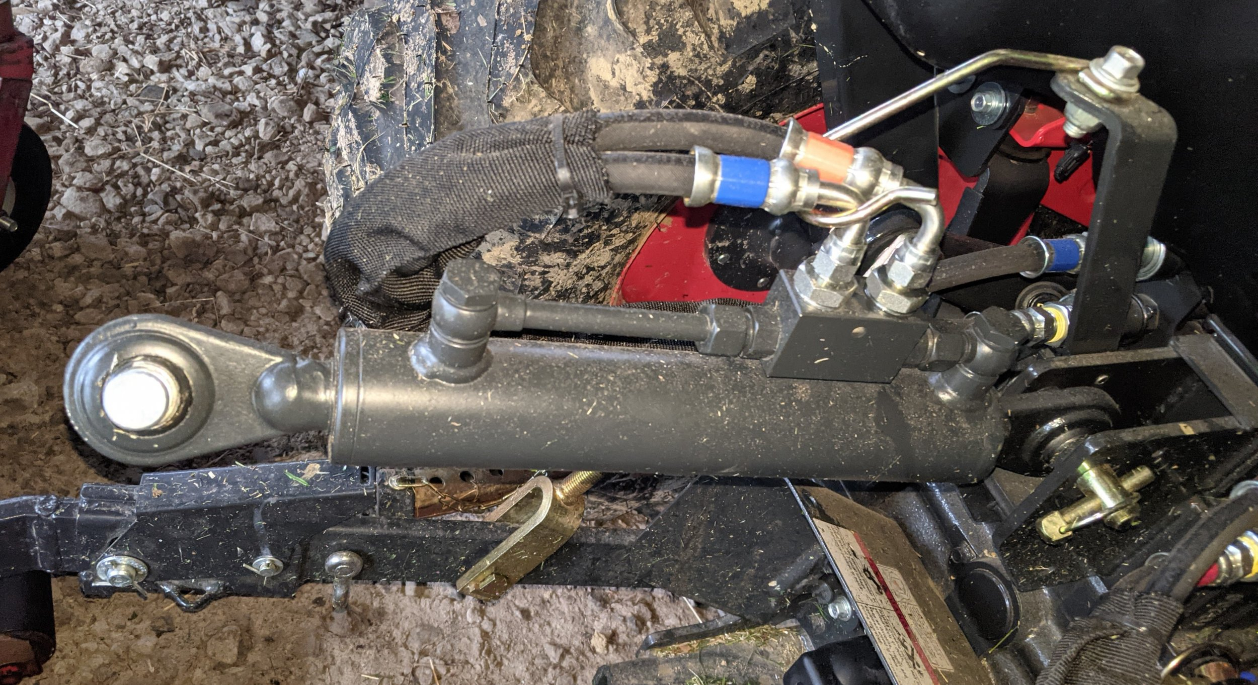

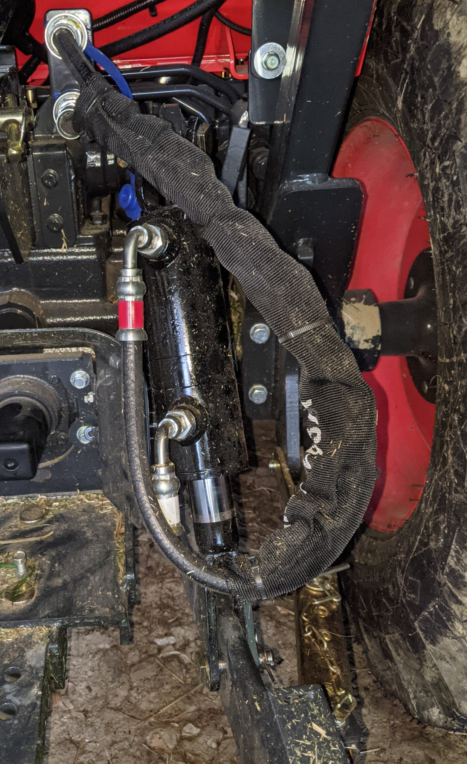

I recently purchased and installed a top and tilt kit on my CK3510. Being a new tractor owner, I figured a plug-and-play kit spec'd by a professional was my best bet. I got my kit from Michigan Iron (KIOTI Tractor 3-Point Top-N-Tilt Kits) and I'm very happy with it. Took 5m to install and it came with everything, fully assembled. I would highly recommend it's. The side link cylinder even has the same custom angle as the OEM side link.
The only thing missing from this kit would be a larger wire clip to hold the new top link cylinder. As you can see, the stock clip for storing the fixed top link is not large enough for the cylinder. Also, probably don't hang your cylinder from the hydraulic fittings as I have done. This was just to hold it up for the photo.

What size cylinder did they use? Can you float the top link? Thinking of getting a set up for my DK5510.
   / Kioti CK3510 tilt kit #6
Float for the top link would depend primarily on the rear remote valve. Unfortunately, a float valve is not a factory-offered option on the CK3510SE so mine does not float (I have spring and detent). Probably your best bet is to email and ask them the cylinder information for the DK10 kit as it might be different than the cylinders used on my CK10 kit.

they don't seem to list any specs on their site - what the min/max lengths on the top & side travel cylinders?
   / Kioti CK3510 tilt kit #10
I'm
I'm pretty sure that they use a 4" stroke for the side link. That presents an issue of not having an equal amount of tilt angle available to both sides and still maintain the OEM center point dimensions. (As in what the fixed left side link is)
