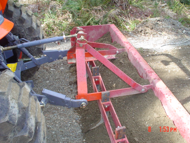

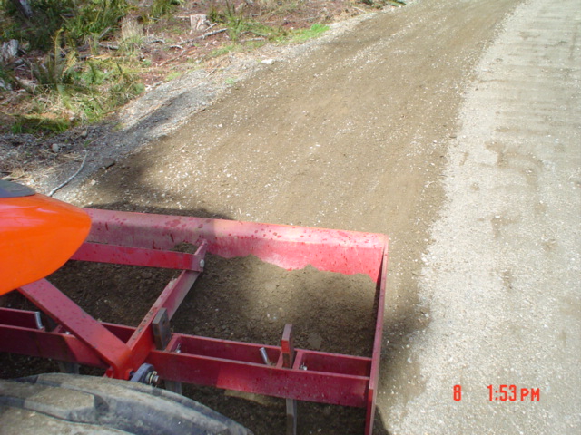

I have a 6 ft box blade on my CK35 HST, have R4 tires, not loaded. Does a nice job. :)
I agree with Gittyup, get a heavy one.
