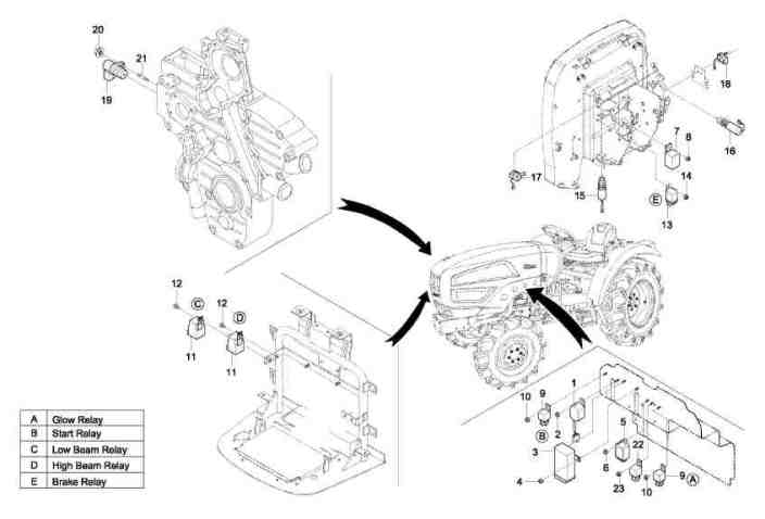

I own a 2006 Kioti CK30 tractor and it doesn't want to start most times. I did find a mouse nest under the engine hood and removed it. There were no mice in the nest although there was at one time. They managed to chew the outer casing from one of the two wires leading from what appears to be some type of sending unit. I'm not sure if it's for the fuel though. The unit is located to the right of the fuel fill cap. I used electrical tape on the exposed wire. Before I found the nest I wondered if the fuel filter was dirty so I removed and cleaned it. I purged the fuel lines of air and it started right up. I let the tractor run for about a half hour. The next day I went to start it and it wouldn't. I haven't been able to get it to start since. The engine turns over nicely and no heavy white exhaust can be seen from the exhaust pipe. The tractor was kept outside all last winter and started without incident. I put up a building to store it in and to protect it from the winter elements and I seem to be having more problems than when it was not under cover. I'm sure this is just coincidence, but... Any suggestions? I do add an additive to the fuel that includes anti-gel solution ingredient.

If it's the glow plugs not getting current, most of the time it's the glow plug relay that goes bad which isn't an uncommon problem. It's on the left side of the firewall as in the picture. wire diagram relays.jpg
Here's another picture from a dealer's site, Michigan Iron and Equipment. It shows the price and as you can see, there were several revisions. http://www.michironandequip.com/pag...M-T940A/01-03|~CK30-M-ELECTRICAL/0103CK300087
There's also a fuel shut off solenoid, about 1 1/4 in round and 3 in long that is mounted to the front of the injection pump. Do you here this click when you turn the key on without cranking? There are two styles and I don't know yours by the year. Here's two pictures again from MIE. http://www.michironandequip.com/pag...G703-00280)/01-03|~CK30-M-ENGINE/0103CK300091

Thank you VictorW! Definitely a few things I can try here. I'm now leaning toward the glow plug relay being the problem. When the tractor did start it was in the 40s making me think it didn't need the glow plugs to get it started. When it didn't start it was in the low 10s and 20s with a cold northerly wind. I live in Vermont and the weather has been unpredictable lately. It's warm one day and cold as **** the next. Thank you for providing the links. The diagrams are very helpful.

I'd like to give an update on the tractor not starting. It turns out that the battery didn't have enough voltage to start the tractor. With the assistance from someone else we were able to check how much voltage was in the battery without trying to start it. We then turned the ignition key to draw on the battery and it was too low for the tractor to start. We purchased a new battery and haven't had a problem starting it yet. It's starting just fine even in the cold weather which is when I was having the mot trouble. I want to thank everyone for their ideas and time for posting. It's greatly appreciated.
