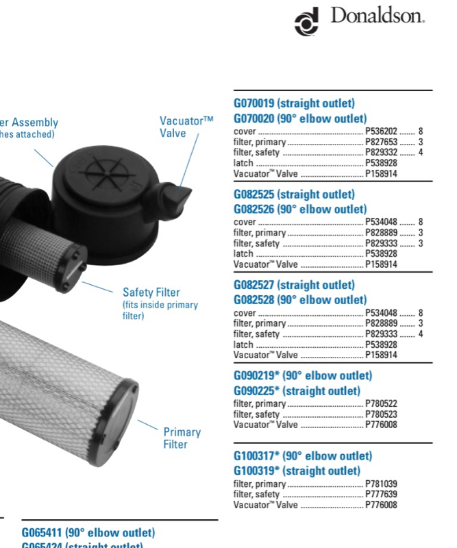

I'm curious about the Donaldson 822769 filter. When I had my ck2610 dropped off, the driver was showing me around the tractor and mentioned there were two filters in it. He was then surprised when he opened up the can and only saw the one filter.
I'm in a pretty dusty area- I wonder if it would benefit me to run the extra filter, at least until winter. Other than increasing fuel consumption a bit, do you see any downsides to running two filters?
   / Kioti CK2610 Gear Pre Review #8
I added the inner to mine after I got it home, I just looked up the filter housing number off Donaldsons site and got the filter number and ordered one. Here is a page from the PDF it has mine on it but not sure yours is or not but just look it up if not.
   / Kioti CK2610 Gear Pre Review #9
Thanks guys,
I'm going to add that as well. I makes sense to be extra safe with the engine. I'm surprised Kioti never included it as standard in the first place.
