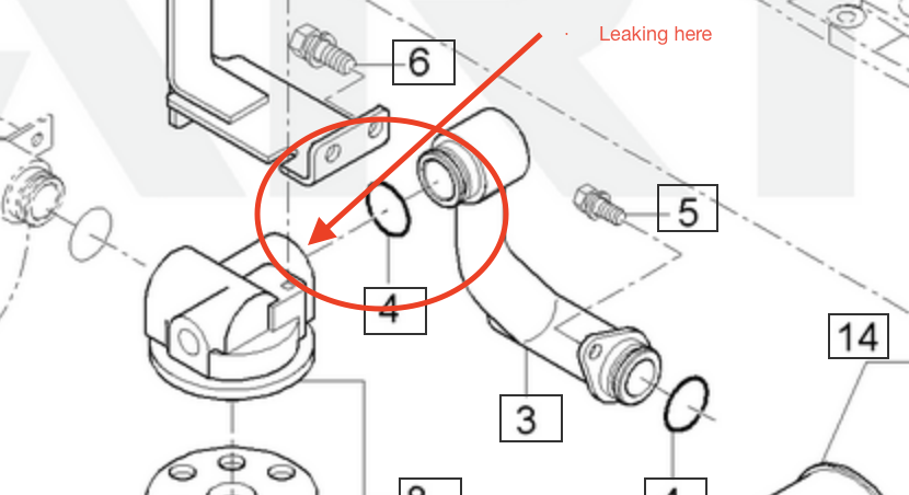

Hey All -
Recently was clearing in a rocky area, and i noticed a sweet smell. Turns out i'd backed up over a rock and dinged the hydraulic filter.
I was able to limp back and park.I have since replaced the filter and fluid, but all hydraulic fluid will leak out slowly from above the filter itself.
It appears that the hydraulic filter assembly, where it connects to the input tube, has been pulled slightly loose, and will leak slowly over several days.
I've got an appointment, but the local dealer is over a month out..
Any recommendations would be greatly appreciated.
   / Kioti CK2510hst - leaking from hydraulic filter assembly #2
Just from the diagram U posted I'd change the 0-ring (#4).
If that failed to cure the leaking I'd next suspect the male threads on pipe #3 might have cracked enough to leak, if so a replacement of pipe #3 would be my bet.
My 2 cents!
