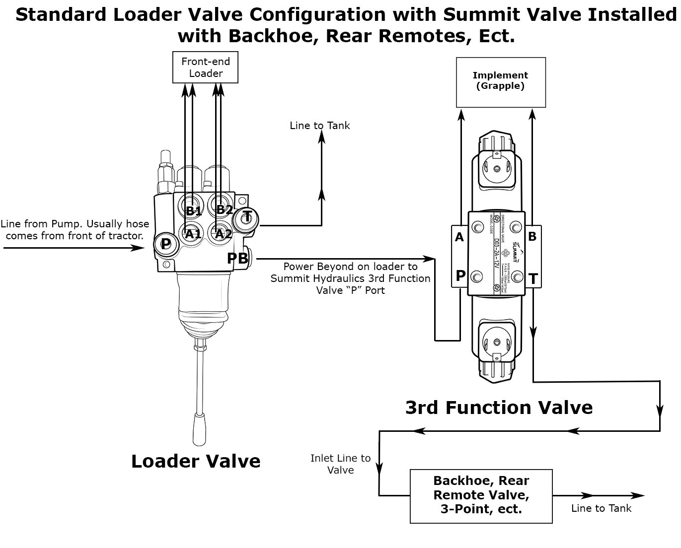

Hello all. I'm trying to locate the power beyond port for the ck20s so i can add a grapple to the fel. Ive scoured the web but cant find ck20s specific info. KIOTI referred me to local dealers--local dealers are being.. difficult.
I spoke with summit hydraulics and they told me I could tap into PB port on the fel valve body. The valve body does have a couple plugs with hex heads on the p1 side and T1 side. I attached the diagram they sent.
Im looking for confirmation on this info. Ty
