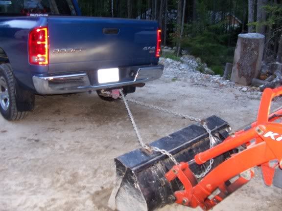

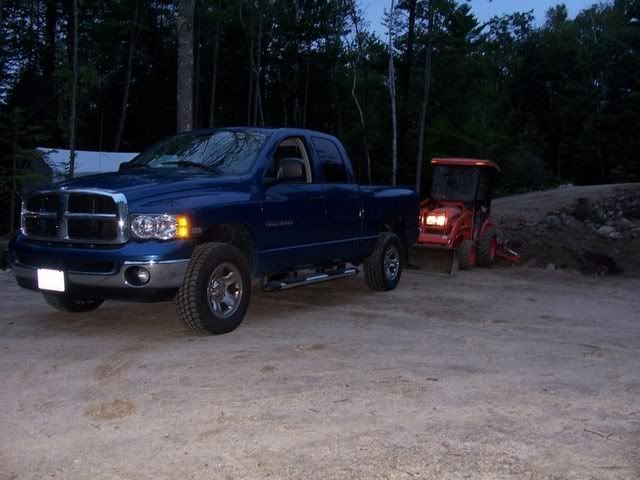

280 hours on my CK20HST and more than half of those are on the backhoe removing stumps and installing culverts. I have not had any problems with it so far. I did need to replace the seals in one of the stabilizers (outriggers) but that is because I had a large rock fall on the piston and it knicked it bad enough to ruin the seal. I beleive anything hydraulic will leak a little when sitting because there is no perfect seal. When I remove the backhoe, I pull away and then move the joysticks to make sure it sits on the floor and there is not stress on the seals. Even when it's on the tractor, I lower the stabilizers and bucket to the floor instead of leaving them up whenever I put away the tractor.
The CK20 backhoe is amazingly strong for it's size. It easily overpowers the weight of the tractor. That's why I hook it up to my truck when pulling the big stumps. :cool:
