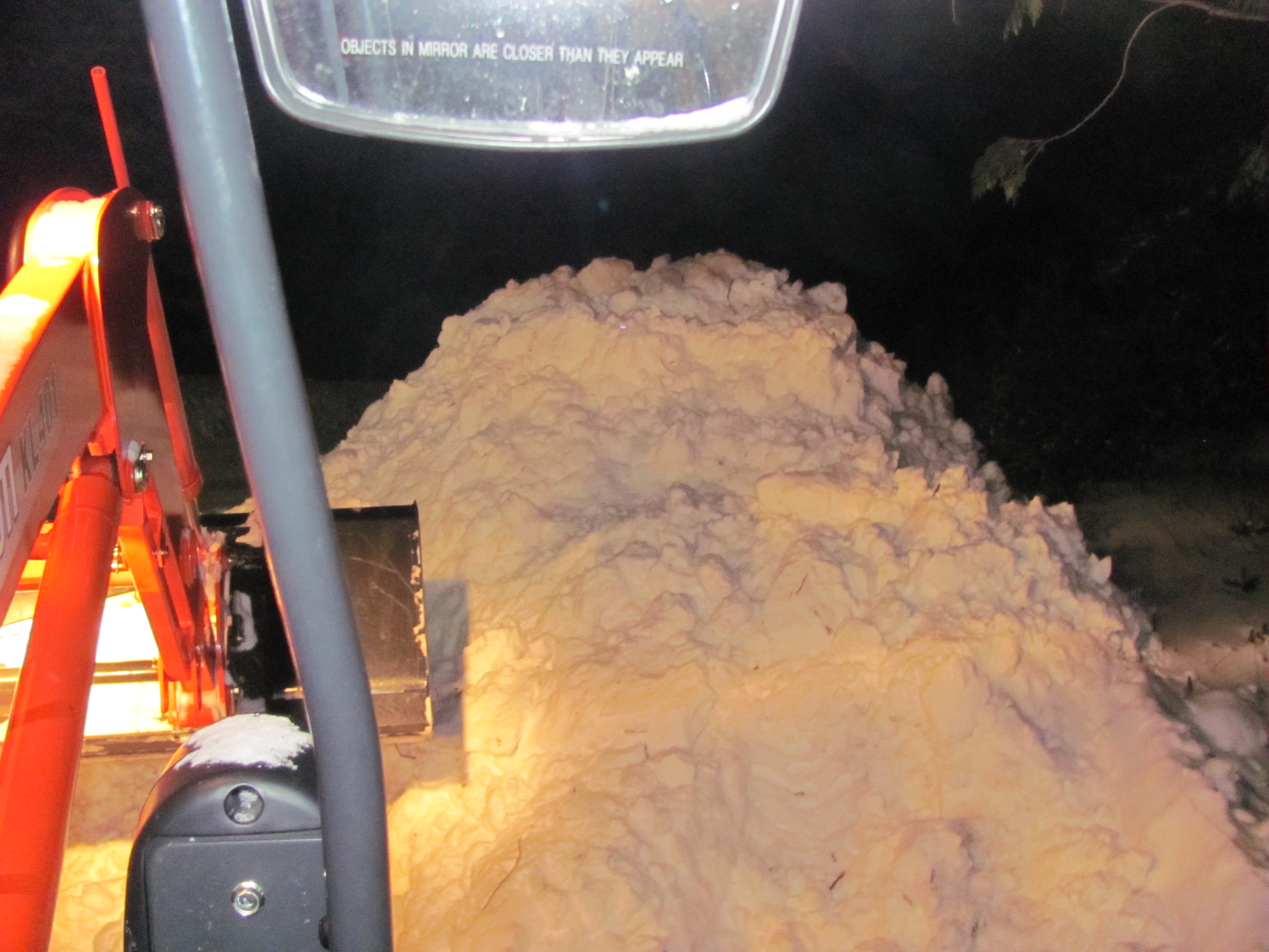

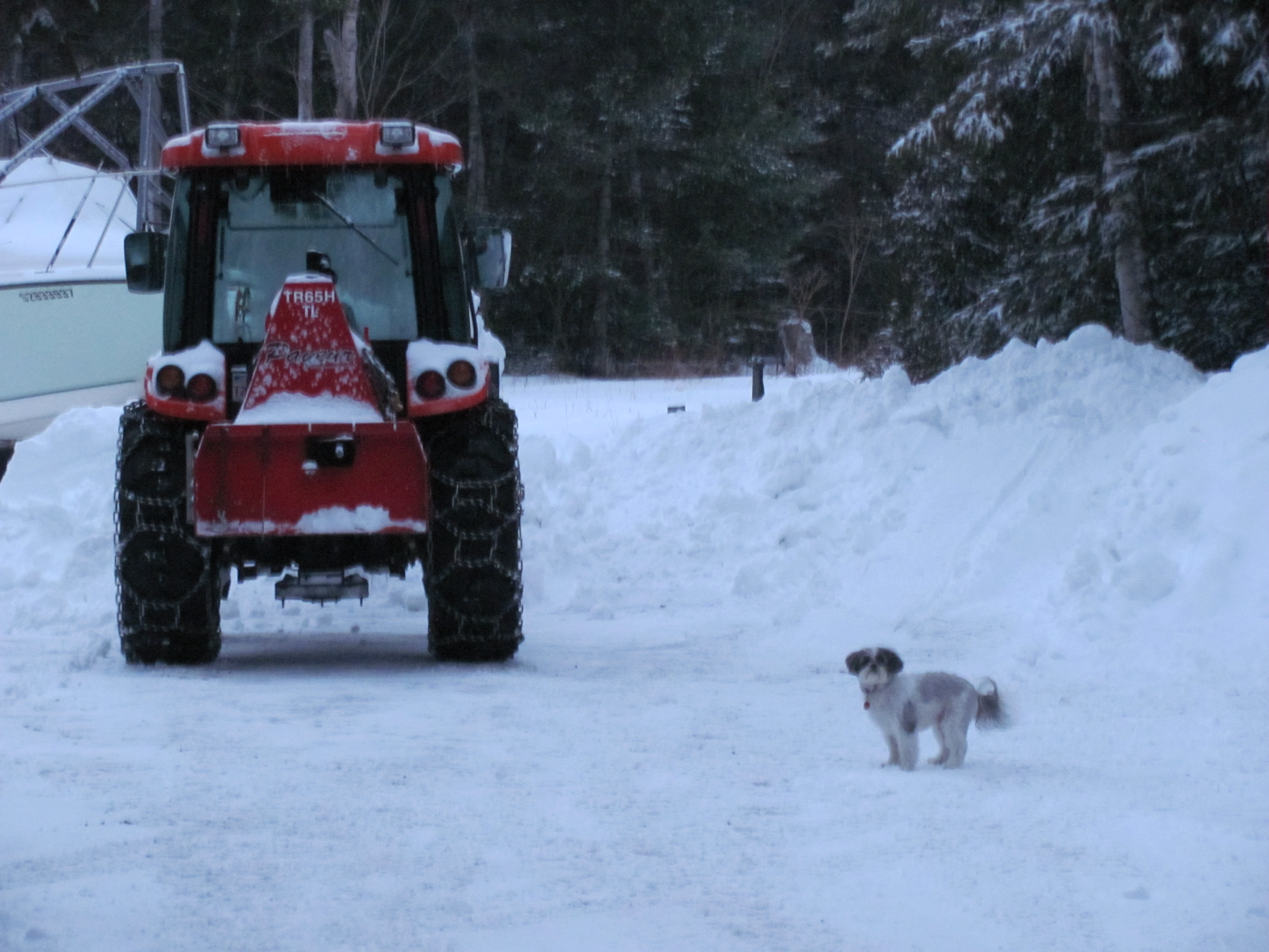

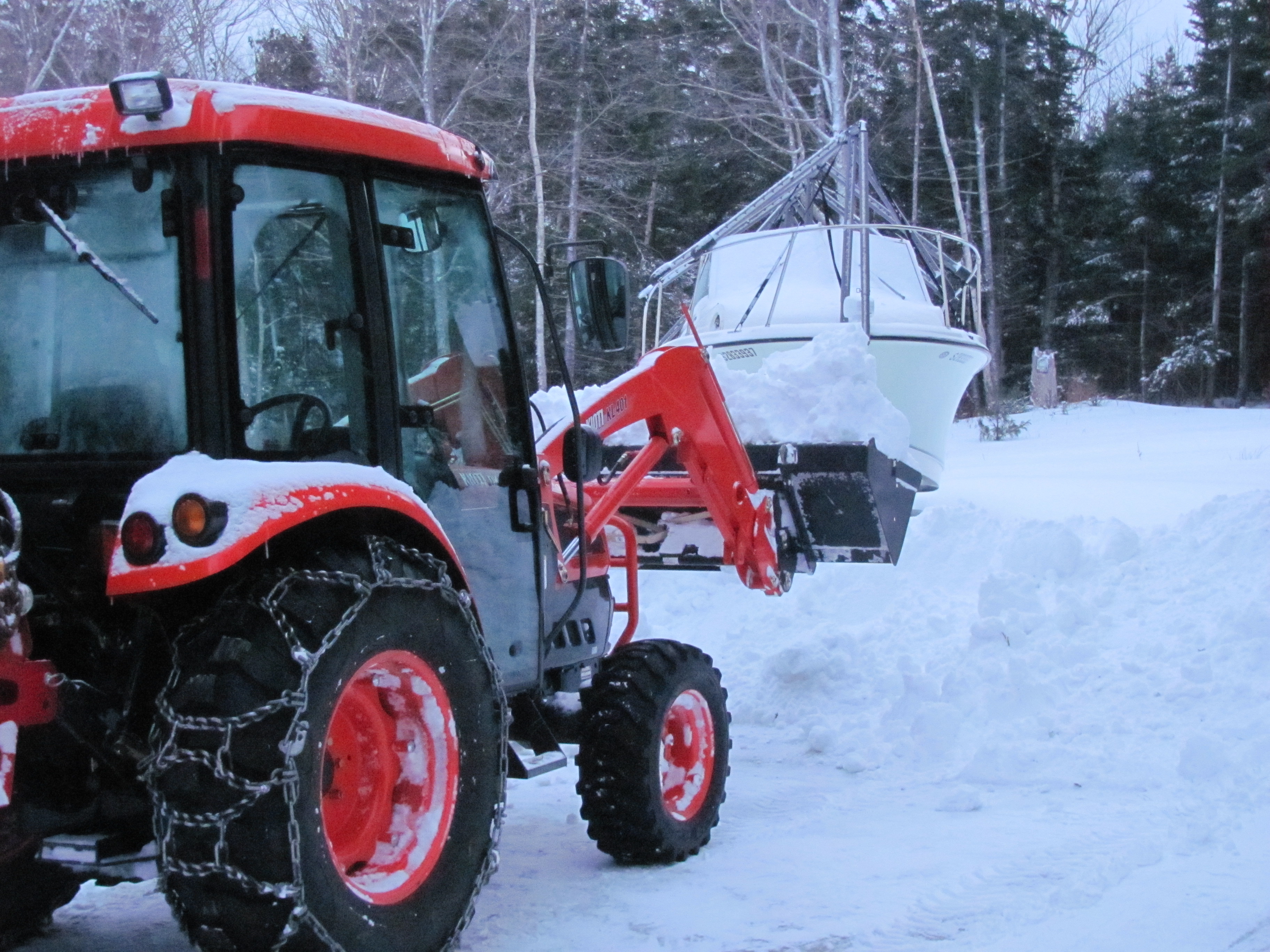

I'm not saying your tractor won't handle it but you wold want lots of weight aft and chains I would think.That 600lbs. is heavy out there. I use my bucket.IMG_1577.JPGIMG_1579.JPGIMG_1580.JPGIMG_1595.JPGIMG_1615.JPG
