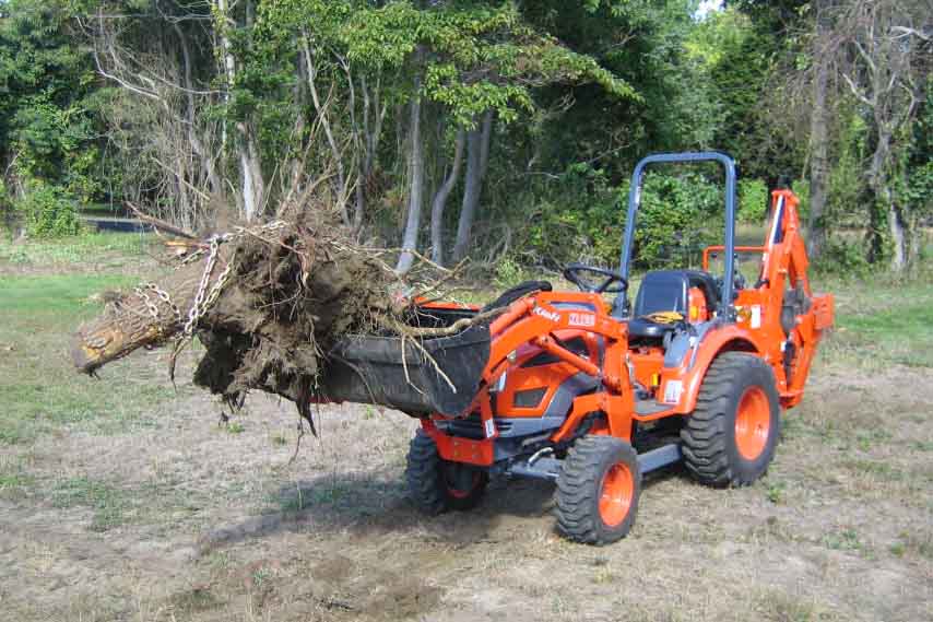

I am using my set up mostly to clear brush, pull stumps and bush hog. The one regret I have after spending all weekend out in the field working, is that there is no grapple attachment. I made do with a chain and chain hooks (see photo) but that was far more cumbersome and involved getting off the tractor twice for each load. You mention clearing brush from a 10 acre plot; if I were in your shoes I would also consider getting one of the aftermarket grapples from the start. If you don't make sure you get chain hooks mounted on your bucket.
I have not yet mounted a toothbar but will do so shortly. As you will read on the forum, a toothbar makes digging much easier. I managed to use the FEL without toothbar to rip out some 3-4 inch softwood trash trees by pushing them over then using a shallow dig to get under the roots. A toothbar would clearly have helped with this and I intend to install one soon.
