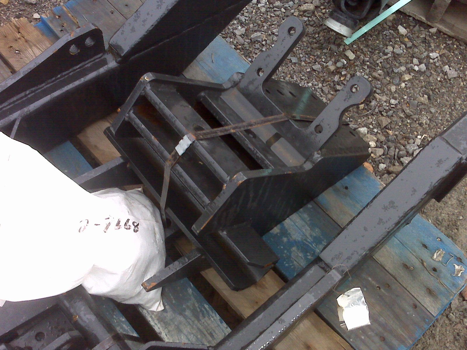

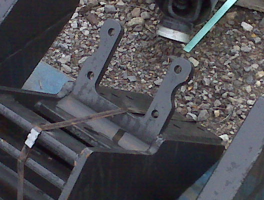

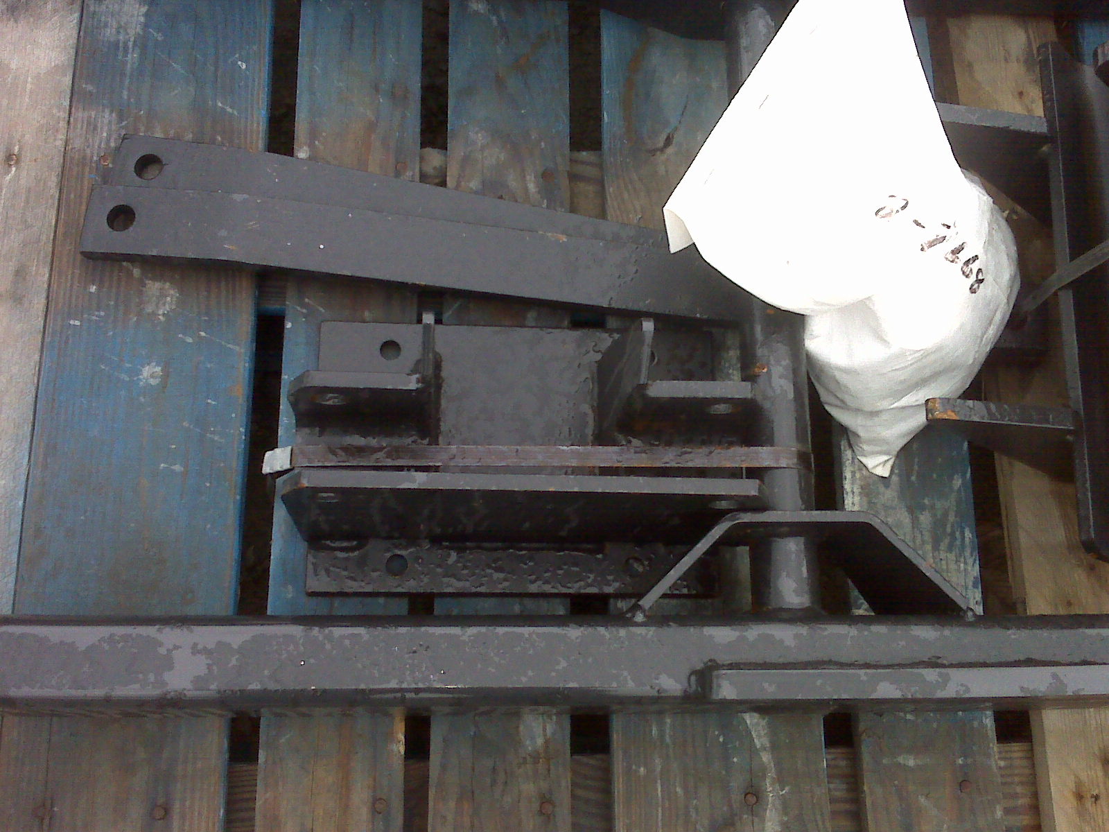

Bobcat loaders are made by RHINO, on the id plate says built in USA. I bet the backhoe is also a RHINO. Anyway, here's what the sub frame and mounts look like.
1st/2nd pic is the rear bracket that mount in place of the oem draw bar support.
3rd pic is the front of the subframe
4th pic is the front bracket

   / Kioti BH on Bobcat? #5
Yes it will go on..
Will you be using a Kioti subframe or a bobcat subframe?

   / Kioti BH on Bobcat? #7
To be sure....Buy the Bobcat subframe, then use the Kioti Hoe.
If there are changes that need made they will be minor.
From the look of the front of that subframe it is a little diff than the Kioti.
