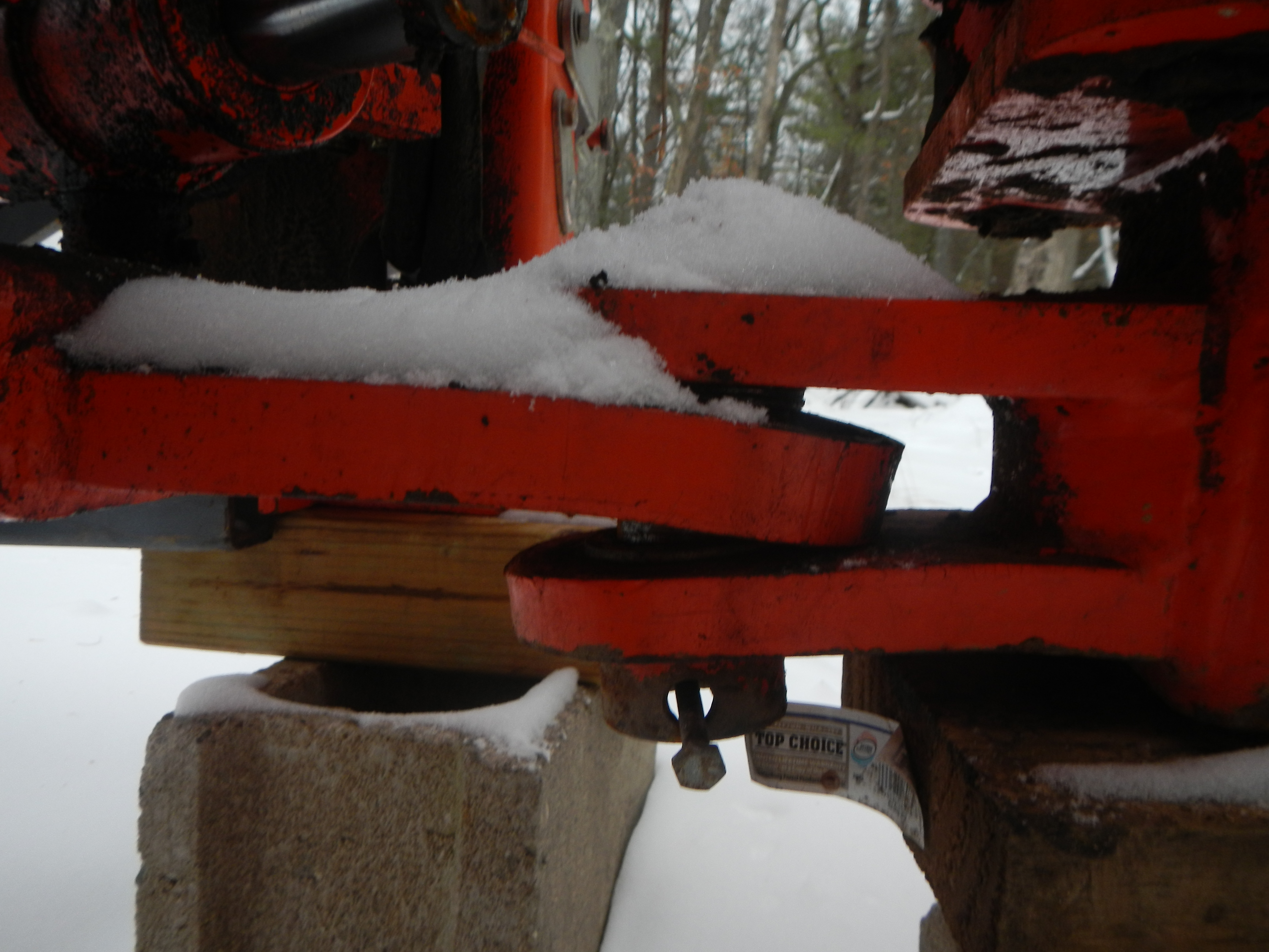

I had mine welded after it broke right at the end of the rod where it meets the attachment knuckle, no problem. As for the pin loss, in the original set up, only one bolt held the swing pin in place. Hit a bad bump and the bolt breaks and pin drops straight out. I had the machine shop build new pins but these one have a "top hat" that is larger diameter than the hole. Lube channel drilled in to top hat and down to get grease where it is needed. Have not lost a pin since, even though I had them make a spare one).

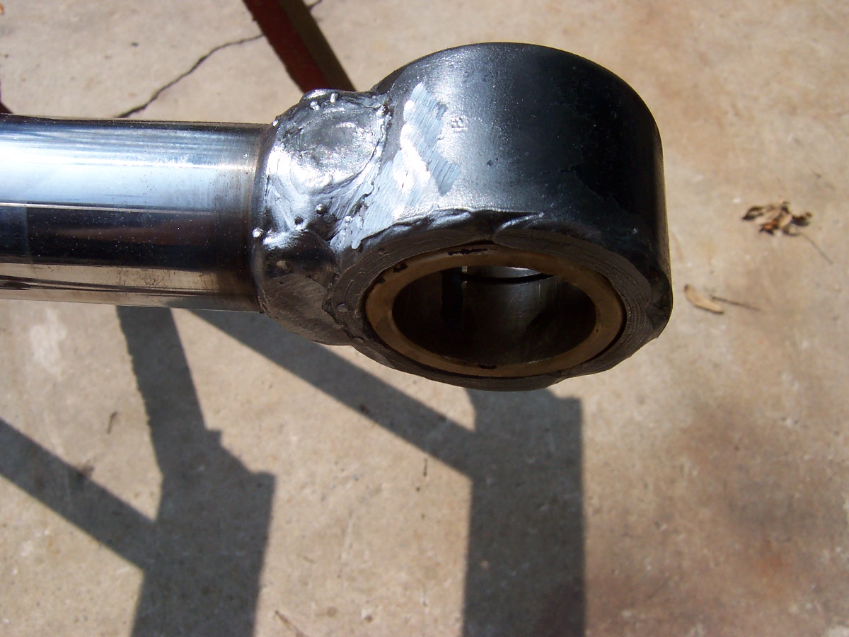

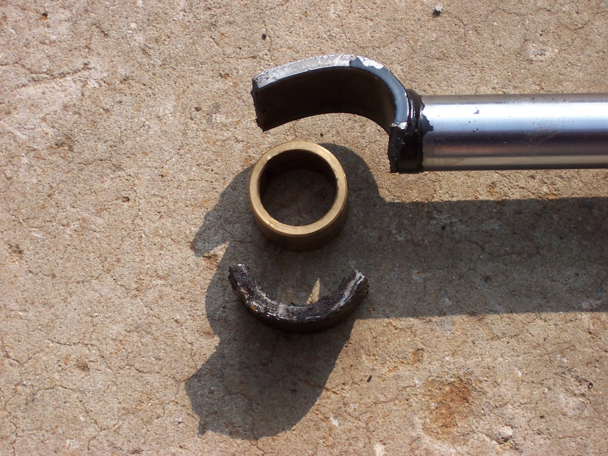

I have a Jinma Hoe for my Branson 3510.
I had one of the ends on a cylinder rip out.
I made a new end for it and welded it back together.
If the rod is still straight yours can be cleaned up and welded.
But make sure who ever welds it protects the rod from spatter. It will ruin the rod if it is not covered.
And don't let the rod get too hot because it will burn the chrome plating. It needs to be wrapped with a wet rag.
As for the bent parts, I personally would want them straightened so it doesn't cause more damage.

Welding! Yes, the eye can be welded successfully, but protect the shaft, go slow letting it cool between passes. That's probably not chrome plated but more likely TGP(turned ground polished), as most cylinder shafts are. TGP is a harder denser metal than mild steel and welds like crap typically. I personally don't like welding on it but I do because people need their things repaired. Get yourself a new pin and while your welder is letting the shaft cool he can add a hat on top of the pin with a flat washer or something scrap lying around. Should work just fine. Happy digging!

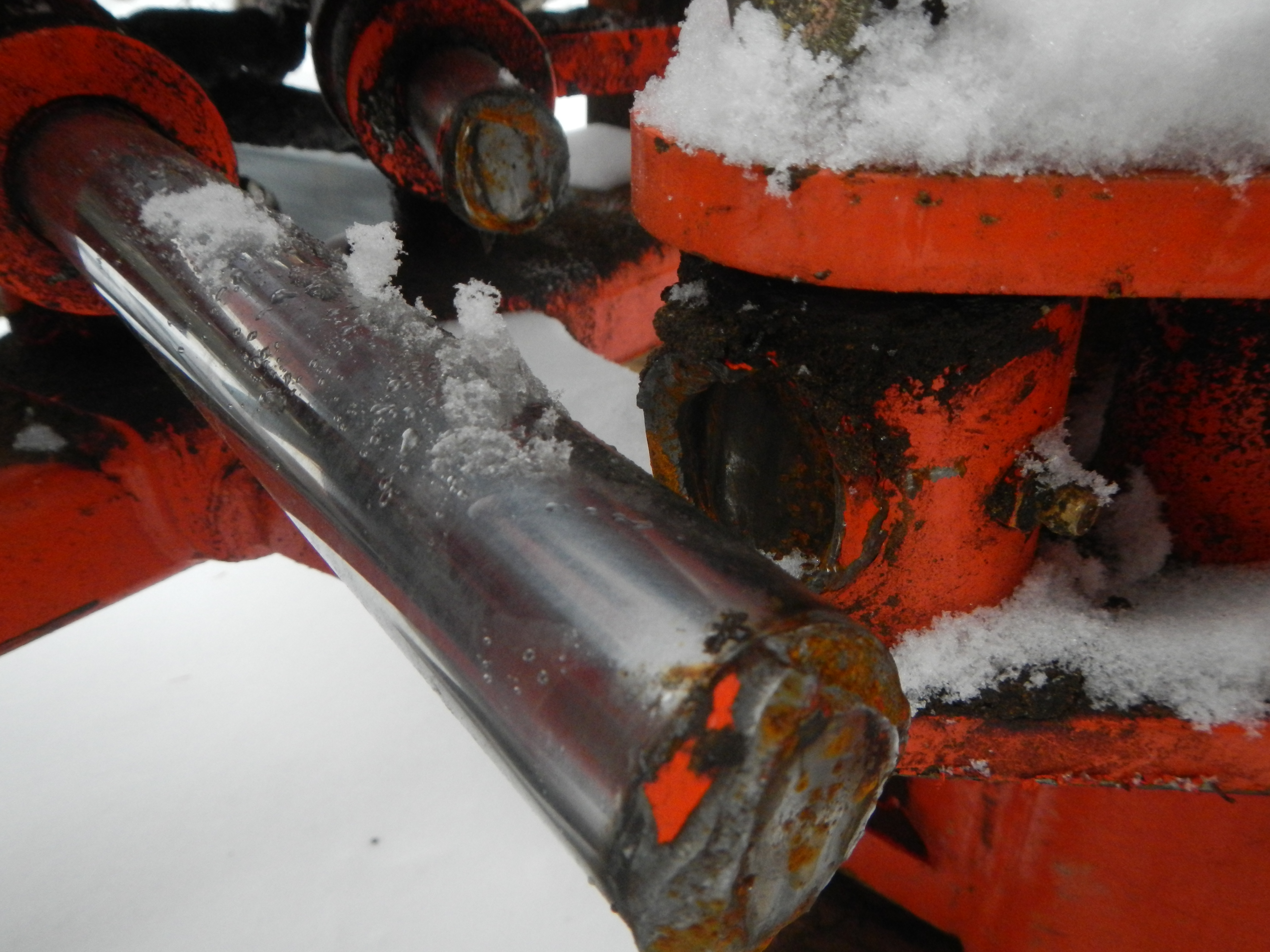

Greasing is good but the lack of grease has nothing to do with pin falling out. It is a straight pin (vertical) in an opened-bottom bore with just one cross-bolt at the bottom (5/16th", I think). WHEN that bolt breaks, (and it probably will if you use your backhoe on less than smooth ground), your BH can slide off the ear and damage the cylinders. Currently, I have my snowblower on so BH is under a tarp covered in snow, so no supporting pictures at this time.Bob
