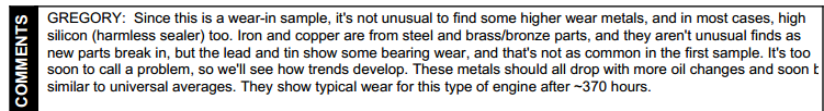

Attached are comments from three engine oil reports. The rest of each report is a long list of various items tested for and their values. The first report comment is at the 50 hour mark using the stock Kioti installed oil and the next two are Chevron Delo 400LE 15w40, one a virgin sample and another I put it at 50 hours and changed at 100 hours. I have another for the hydraulic oil at 50 hours and it read well even though the magnetic drain plugs had small mountains of metallic debris attached.
The 50 hour engine oil had me concerned:

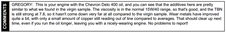

The 100 hour report comments using the Delo 400LE and I feel a lot better now. No clue if the new oil had any impact or not over the original oil, but the numbers have improved a lot- thankfully and I hope the engine is getting broken in. The whole tractor has been used very hard, up to and probably exceeding its stated capabilities many times. Note the comment about how well the oil has performed at this 50 hour interval and it can go a lot longer still providing excellent protection:

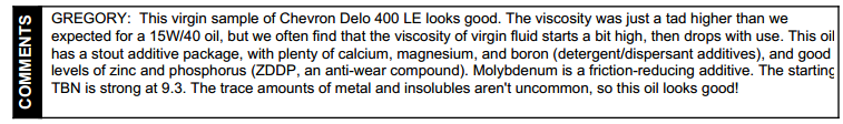

The report comments on the virgin Delo 400LE oil mentioning how good this oils additive package is.
