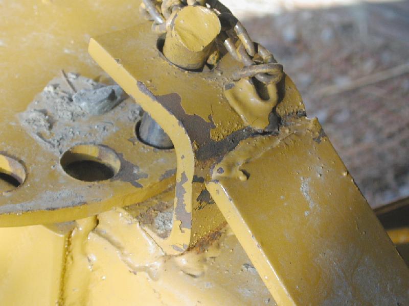

Hi,
I have a couple KK attachments, and I can't complain because I do believe you get what you pay for. /forums/images/graemlins/smile.gif
The only thing I have used my 6' KK back blade for is moving some snow. I did catch a rock or two doing that.
My worry with KK is the quality of their welding. It did not look good to my untrained eye but I figured for the price...what the heck.
Here is an example of what I am talking about [see attachment]. This weld is on the back blade, where the pin drops in to lock the angle.
Notice that the weld is so poor that it did not even penetrate the steel at all on the one side. Went on more like hot glue than weld...
THis is the reason I don't think I would buy a KK rotary cutter. I'd be afraid that the welder that built my back blade would also have made the cutter I was buying!
Now I am sure that there are a lot of properly-welded KK implements out there. But I don't have a lot of faith in their quality control... /forums/images/graemlins/frown.gif

   / King Kutter XB #10
Her's a second shot looking down from above for anyone who is interested...
