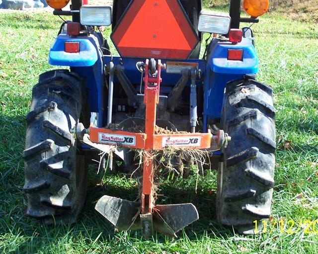

Used my middle buster to dig a trench and plant Osage seeds with the other day.
The sub-soiler works well taking out small (3-4") stumps.

How deep and how clean a furrow is that leaving. I need to bury a PVC conduit for a new light at my wood pile. My BH can do it but that's quite a mess for a small conduit. I'm not renting a trencher for a 45' shallow run.
   / King Kutter XB Middle Buster/Sub Soiler
I didn't take any pictures of the trench, but I was going about 6" deep in 2 passes. One pass to break every thing up and the second to clean it out. It does a fairly good job of throwing everything to both sides, you will have to occasionally take a big clod of dirt out of the trench.
