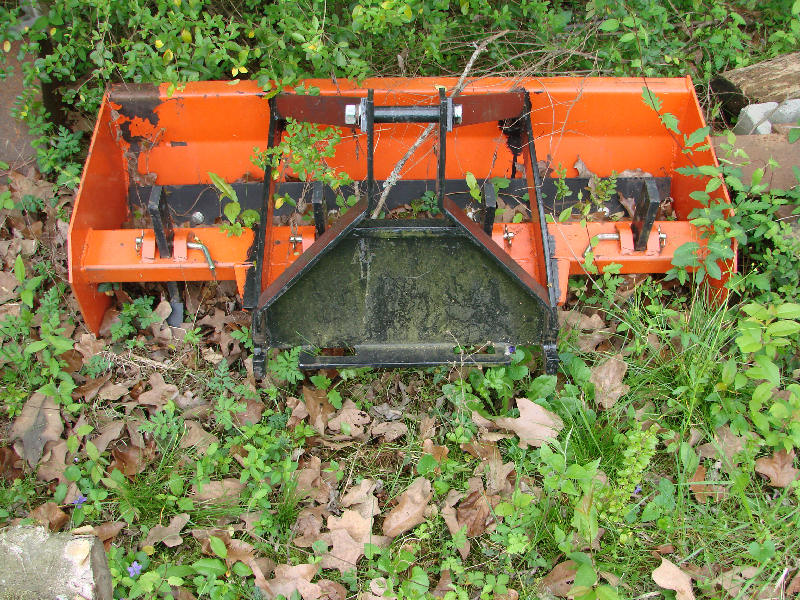

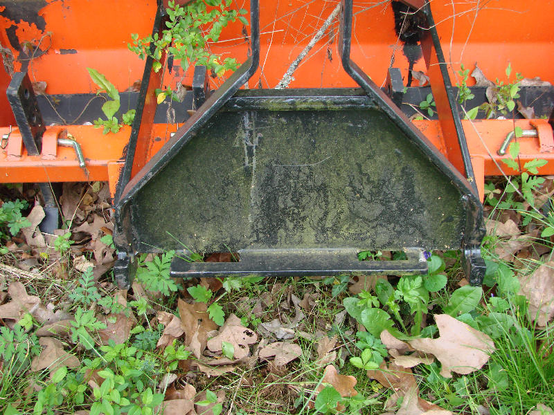

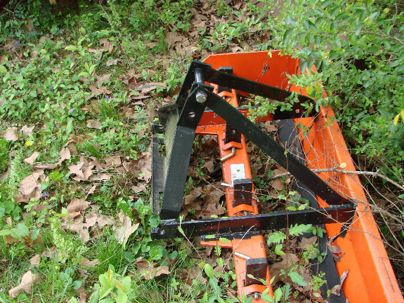

I promised a couple of pics of my King Kutter boxblade that I had a T8 (422/425) QA plate mounted on. Though I didn't use it this trip, I did snap a couple of pics of it.
I moved the original upright frame bars inside the two bottom hitch pins, tilted the whole thing back abou 25 degrees or so, and shortened the rear braces. The T8 QA plate fits pretty neatly inside that framework.
