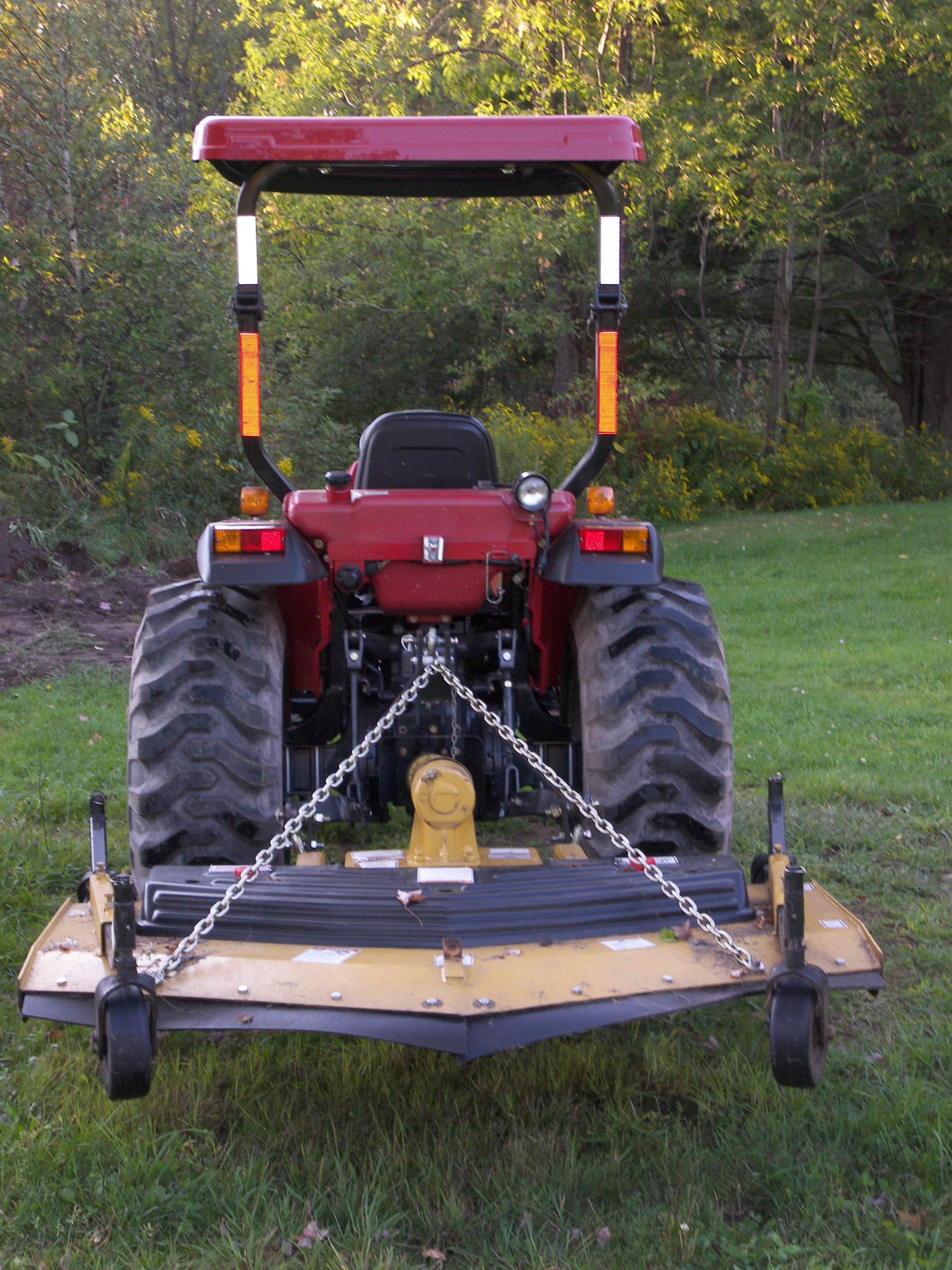

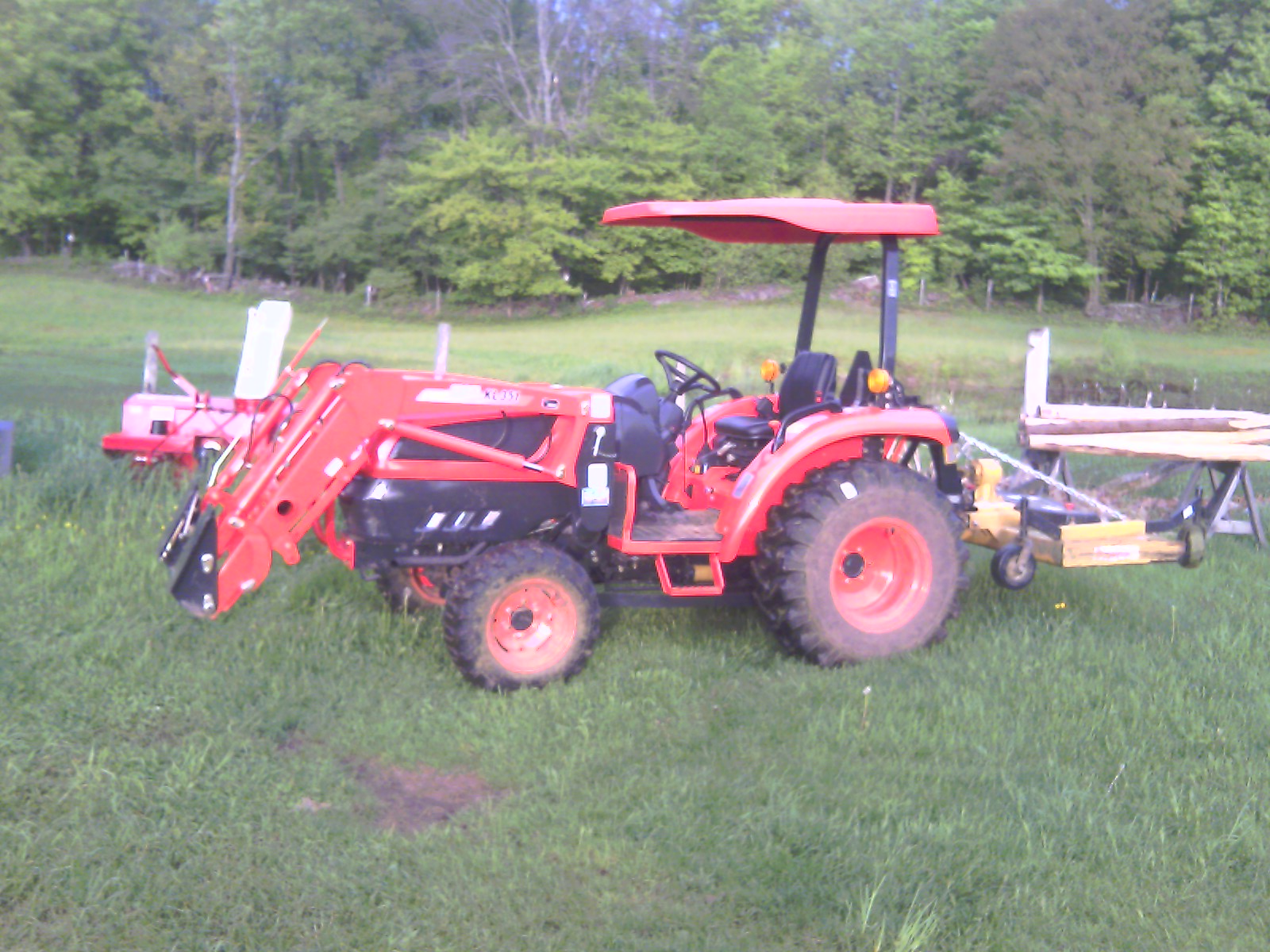

I have a KK rear finish mower and it is "TOP SHELF" as far as im concerned its i guess 5 years old now, used to mow heavy pasture grass and part of our lawn. Probably 6000 acres on it now and the only repair was new wheel bearings and axle bolts which i got at tractor supply for about 25 dollars. I also changed the lift chain from one in the center to two chain lift, one on each corner it runs on a Mahindra 2810HST and also a Kioti DK35SE-HST My mower takes a lot of use and does a GREAT job. Mine has the "fLEX- hitch" and it is great especially on rough ground. I get very little scalping with mine and mine come with "Oregon" blades which by the way, i ground for the first time this spring, they had very few nicks and held an edge nicely . . . .John
