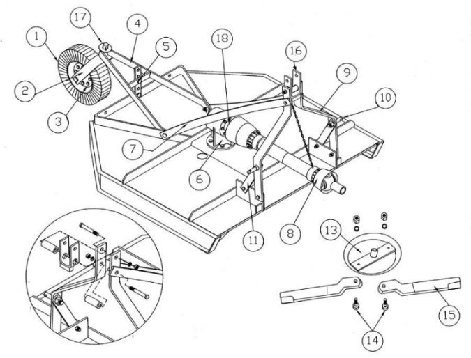

I purchased a used king kutter rotary cutter. I don't know much about rotary cutters, but apparently the top link needs to have some flex in it so that the cutter will travel over bumps, etc.?
I am missing the piece that I believe provides this flex... it is part number 16 in the attached diagram, but $38 seems too high for something I can fabricate. If anyone has this 5' king kutter, could you measure the exact dimensions of the part, and provide it so that I can fabricate one? Thanks in advance for any help

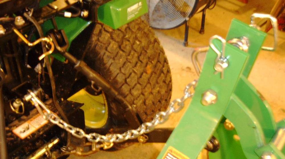

Many of us use chains. They provide a lot more flex than any flexible top link. Just adjust the chain length to keep the cutter from dropping off the edge of a cliff or creek bank.
Attached is a picture of mine.

   / King Kutter Top Link #3
You can buy that figure 8 type clip at the ends of the chain at TSC. My top link fits beside this figure 8 clip on the cutter top link end. If I want to transport the cutter, I can just swing the top link over and connect it to the tractor. Then the trail wheel will lift.

I have a 5' KK and it looks just like the drawing you posted. I don't think having the exact measurements would make much difference. If you bend a piece that fits in there and put the holes so they line up, I wouldn't think it'd matter much (if any).
As Ralph said, many people replace the entire toplink with a chain to get more flexibility with the kutter.
If I remember, I'll measure the part for you this evening.

</font><font color="blue" class="small">( I am missing the piece that I believe provides this flex... it is part number 16 in the attached diagram, but $38 seems too high for something I can fabricate. )</font>
That's comparatively inexpensive. LandPride wants over $50 for the same thing.
But it doesn't need to be that U-shape. Two pieces of flatstock and a bushing/spacer is perfectly adequate. Cut a pair of 8"x2.25" pieces of 1/4" flat stock and drill a 3/4" hole about 3/4" from each end. Round the corners with a grinder. Cut down a pair of 3/4" (ID) bushings to provide inside spacing.
I assume you DID get the lower bolt and spacer bushing? That's necessary to promote rigidity - or - you can use those two holes if you've got a "short" tractor.

</font><font color="blue" class="small">( Many of us use chains. )</font>
I know you won't want to hear this Ralph, but that looks like an accident just waiting to happen. I had a sinkhole open up under my rear tires once, and entire tractor/rotary cutter folded itself into a huge V at the lower lift arms. Toplink pretzled, but at the same time stopped 600 pounds of rotary cutter from flipping up backwards into the tractor seat AND saved the PTO shaft . If I had been using a chain - instead of a proper toplink - I figure at best the PTO shaft would have taken on the appearance of a recurve bow. At worst, the RC transmission could have hit me somewhere between the shoulder blades and the back of my head.
Assuming one would survive such a hit, one would then be facing a significant repair bill when he got out of the hospital; rear fenders, operator seat, PTO shaft, toplink.
Your chain "solution" will flex to a bottom stop point just fine. Unfortutately there IS no stop point at the top - except for you and the tractor.
//greg//
   / King Kutter Top Link #8
I'd have to agree with Greg. I'm NOT a fan of chain toplinks, due to the safety factor involved.
