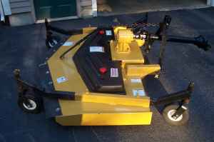

I've attached a pic of the mower in question.
Jim

But, as far as the pic goes, that things looks pretty un-used. Like mentioned above, did you check underneath the deck, the blades, and the belts/pulleys for signs of wear? I would think it should be pretty clear.
I notice the new ones are $1499 currently.
