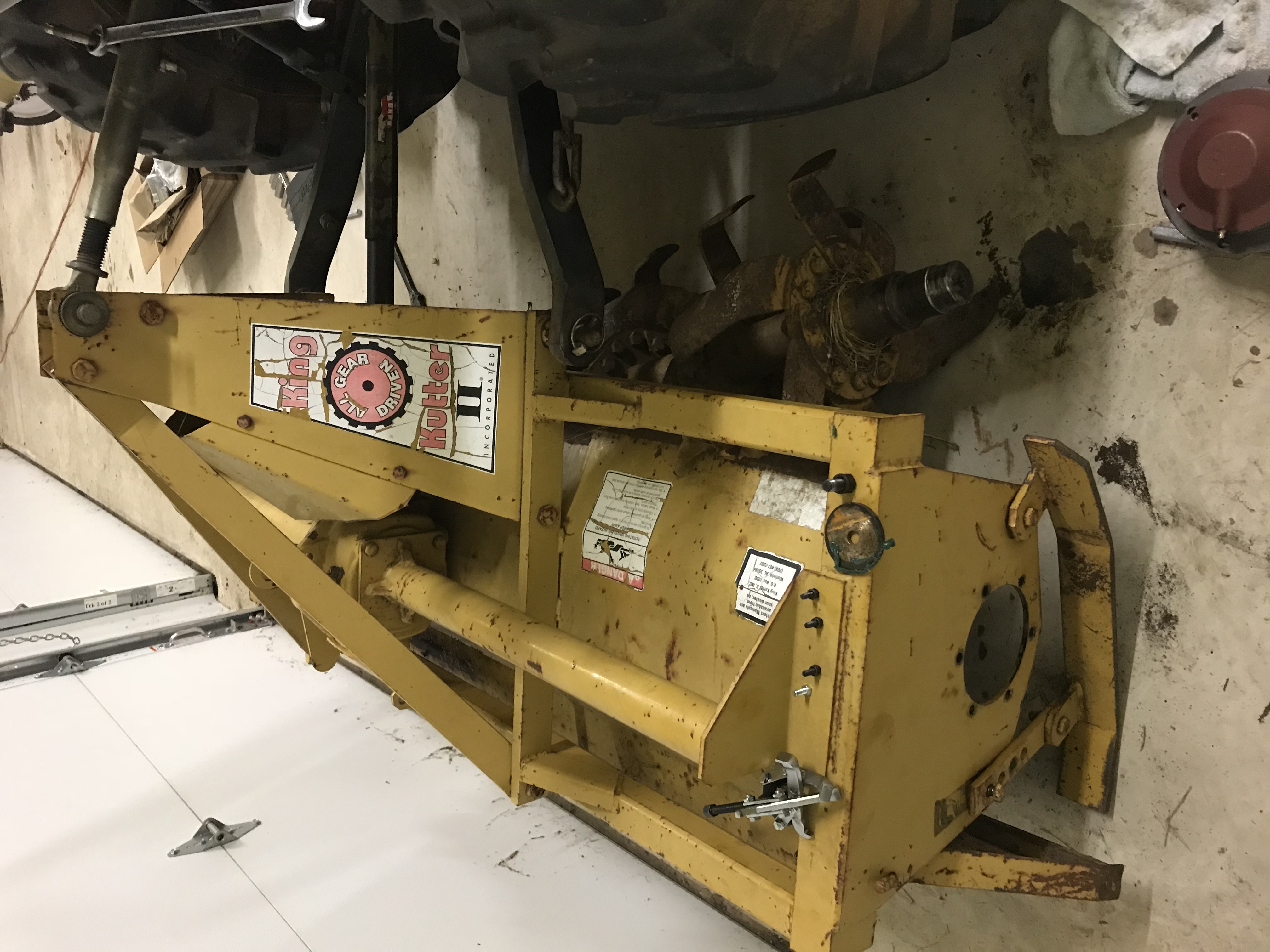

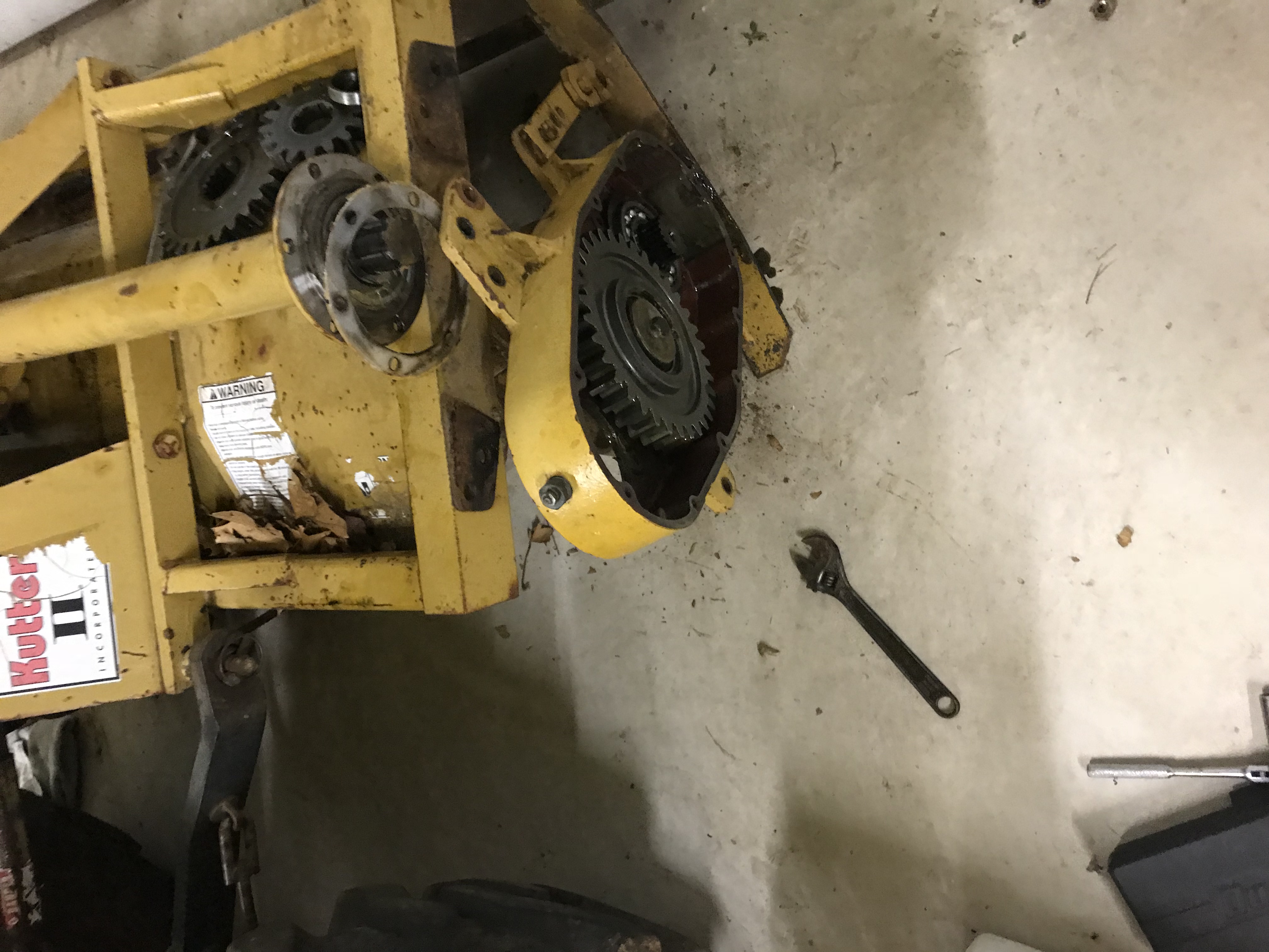

I'm replacing my outboard hub and i had to get it all out from the gear end. Pull the gear box off and you can angle it out the front and get a 3 jaw puller on it. Prybars and profanity got it all apart for me. I had to get an inch longer bolt to press my new bearing back on but your results might vary.

Looking back i should have just cut the outboard flange off a couple of inches below the frame and welded gussets on it that i could bolt back into. Strokes of genius show up too late sometimes
