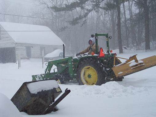

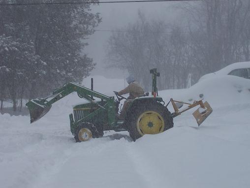

Not sure how long your driveway is, but I have a 7' standard for my 40 hp and it works great for snow removal and light grading. The HD may be aggressive.
