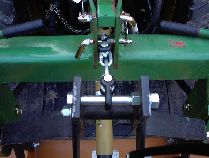

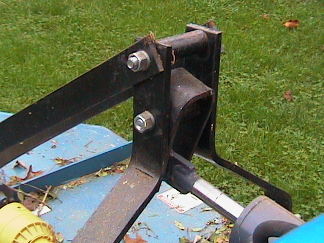

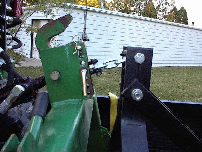

This subject has come up a few times in other posts. The King Kutter bush hog top link bracket is poorly designed and most people modify it. I moved the U shaped bracket to the bottom hole and bent it in so the linch pin will not hit the side bracket. I also put a spacer between the U shaped bracket and the side bracket to keep the U shaped bracket off to one side so the linch pin will have enough clearance. I did mine this spring and it's worked good all summer. I recently got a digital camera, so here are some pictures.
I've attached a picture, rear view.

Re: King Kutter bush hog top link bracket, pic 2
Picture of side view.

Re: King Kutter bush hog top link bracket, pic 3
Picture of front view.

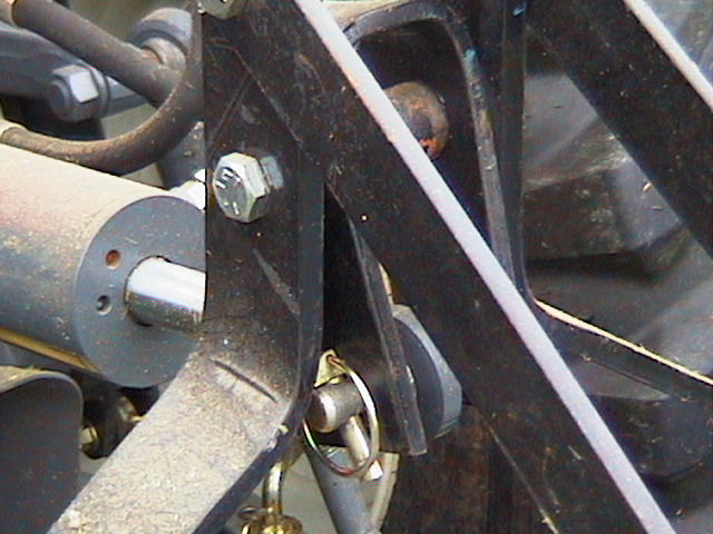

I did not have an issue with the setup that KK had, just came up with a better solutuion of it working with the quick hitch. I use pins to connect the top hook of my quick hitch and when I use the KK cutter I just pull out the hook and connect the chain using one of the pins. This allows free movement of the top connection when going through ditches and such. I use the other pin to keep the hook attached to the quick hitch so that I don't misplace it. Having a hydraulic top link connected to a control valve that has float detent on it also allows for more pivoting travel.

Straight on view
Randy - JD4110
