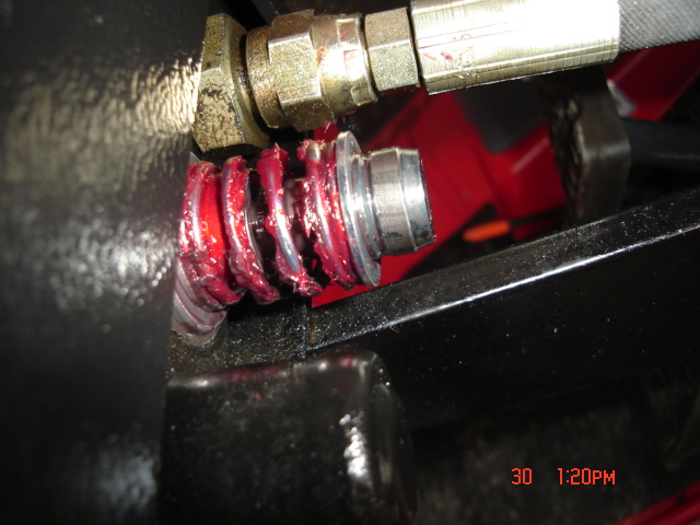

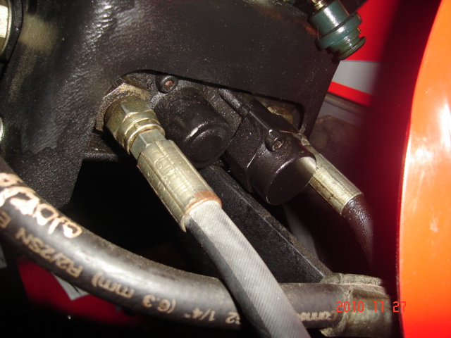

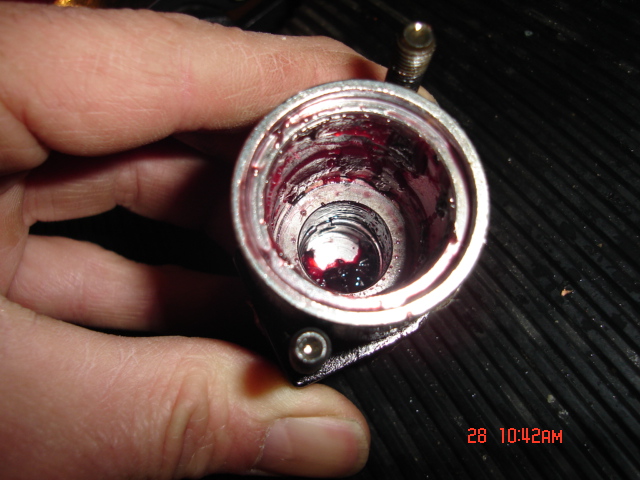

If the Kubota float detent works the same as a Massey...
That's a problem we with M-F SCUTs have had to deal with... could be some rust/moisture/glop in the float detent mechanism, which is pretty easy to take off & check.
On the 2310, it's a sort of cup on the back side (underside) of the joystick control valve block, held on by two socket-head screws. Taking it off doesn't (shouldn't) result in any loss of fluid. In the third pic, it's the taller one. The groove on the end of the shaft (second pic) is supposed to click into the snap ring at the bottom of the cover (first pic).
Very often a clean-up & fresh grease cures it.
