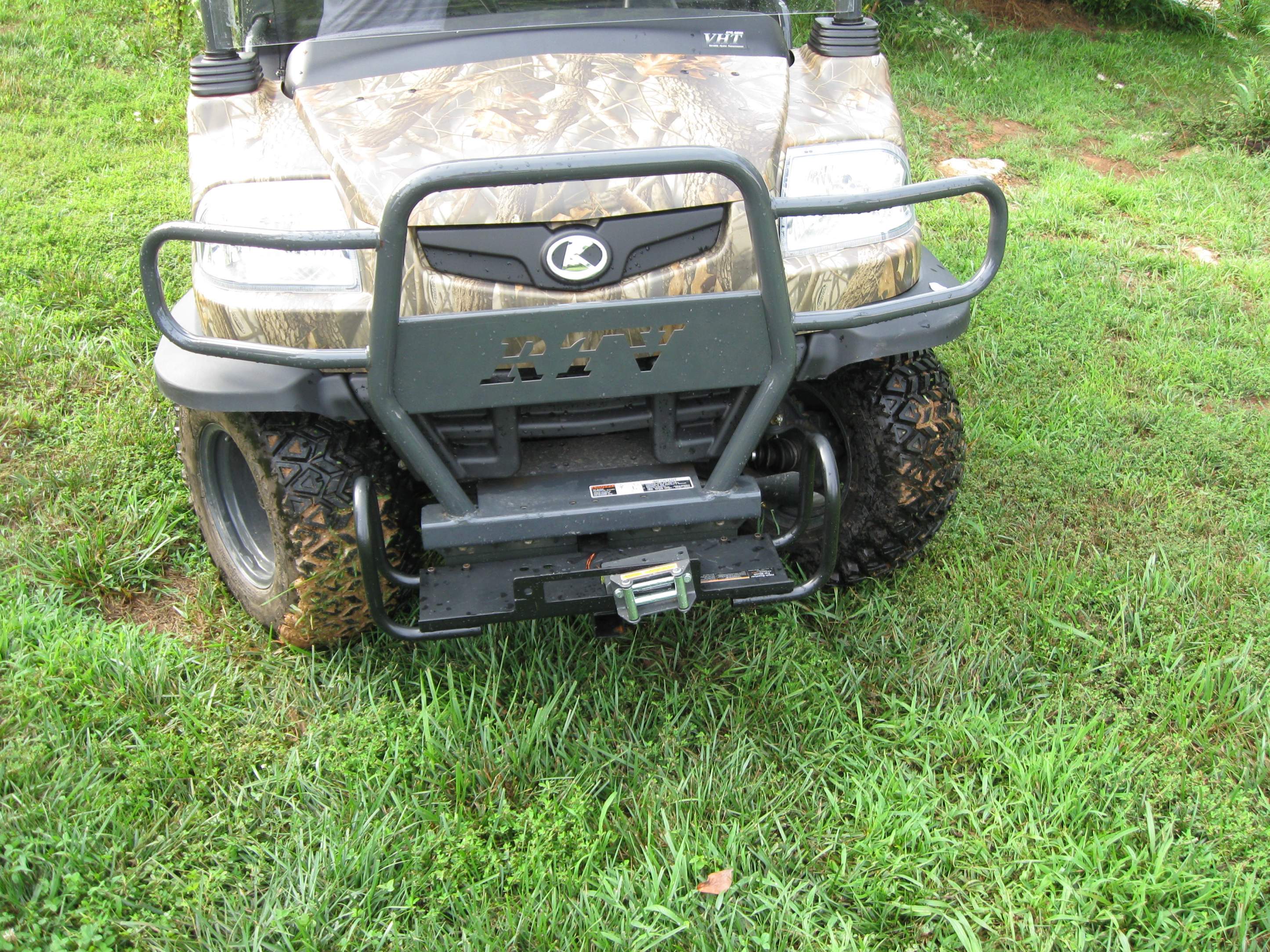

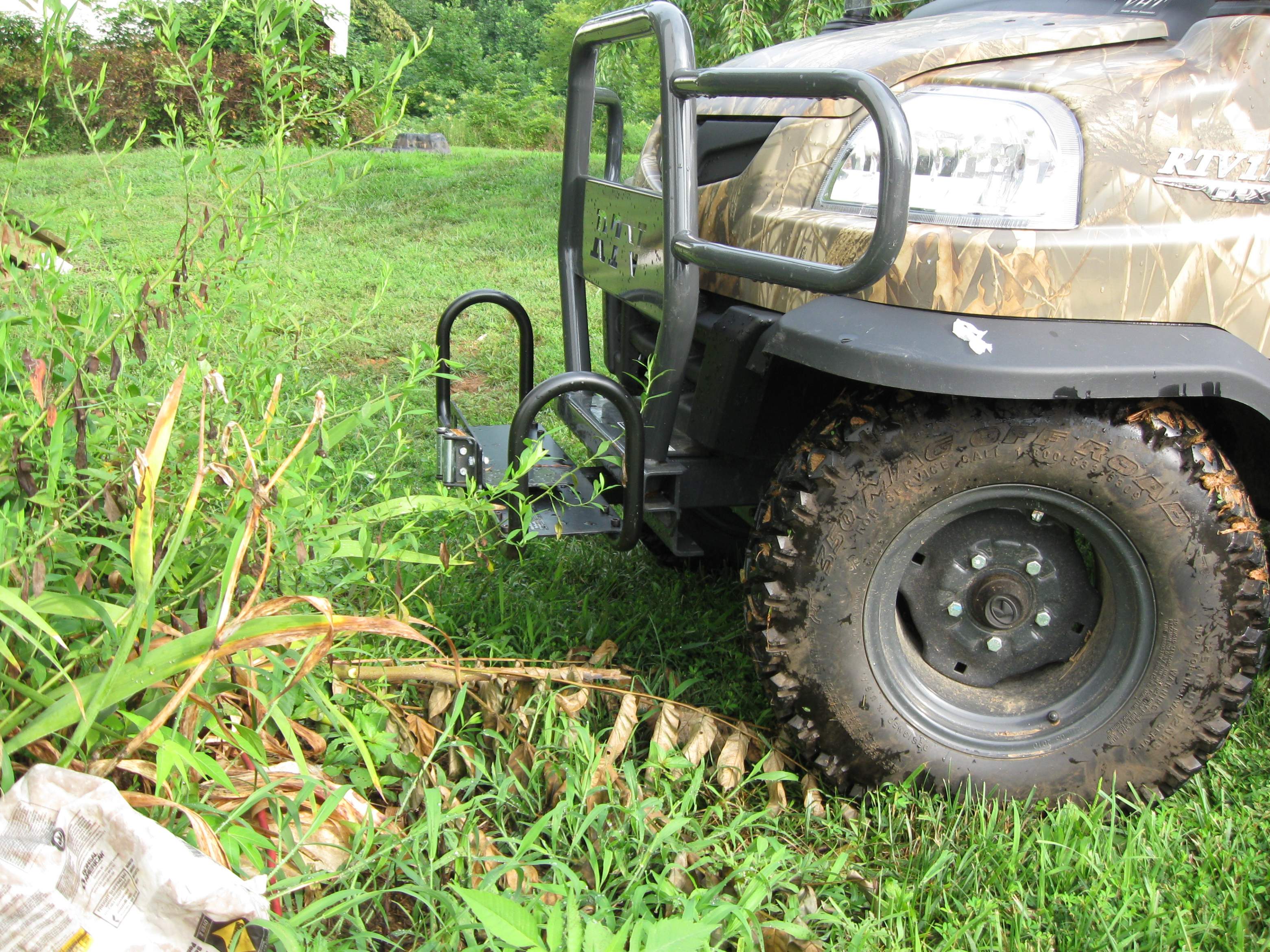

What I've done or started doing. I bought a 3000lb winch from Harbor Freight for around $80 with one of their coupons and this mount for $60 with one of their coupons.
This mount can go on the back but with new holes drilled since the back Reese hitch is to shallow or here on the front with no modification other than specific holes drilled for the base of the winch.
I've stopped completion of the installation due to hot weather and I'm hunting some type connector for the wires going to the battery from the winch so I can unplug it and remove with leads still connected to battery for easy plugging back in when I reinstall the winch front or back. Haven't found the right connector, yet.
Accepting suggestions for a two lead connector to carry the amps and shielded for at least one of the wires.

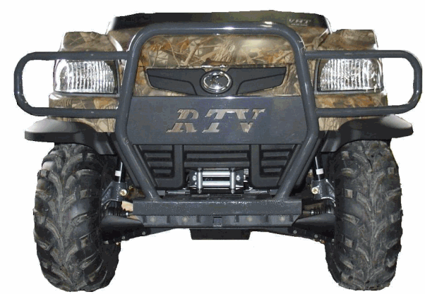

I bought the KFI mount. I haven't had time to install, but it looks like a perfect fit. I found the Superwinch for $174 on a 2 hr sale (amazon deal). I had more than that in "points" from ordering with them over time, so got the winch at no cost. Got the mount for about $45 so I am pleased! KFI web site shows pic of the system mounted on RTV - very nice!
