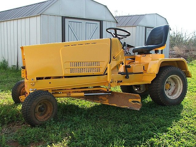

I built this to tend the driveway. Since the picture was taken, I've added a front tiller. I've got most of the parts for a FEL. I just need more spare time.

Thats pretty slick - what was it made from? Looks like there is a small tractor heritage in there somewhere.
   / Kenbota Grader #3
::whistles:: WOW lookin sharp. nice work!
   / Kenbota Grader #4
Man you know how to get right at an equipment operators's heart lol. Thats aneat looking littl grader. I have a factory mid mount blade on my Farmall Cub thats handy at grading but the short wheel base teends to be aggravating. I like the extra wheel base youve added to your machine to. kinda reminds me of an Athey/Huber Maintainer they ae a smalle 2 axled grader that resmeble you machine just a bit larger.

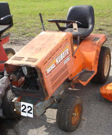

I picked up a Kubota G3200 at an auction and used the diesel engine, hood (extended 18"), front axle (widened 6"), dash and seat. The rear fenders are trailer fenders. Everything else was fabricated or salvage yard finds--The Eaton model 7 trans is run through a Peerless model 2500 rear axle.
The attached picture was the donner tractor.

You mean kind of like a Frankenstein? /forums/images/graemlins/blush.gif /forums/images/graemlins/ooo.gif /forums/images/graemlins/smile.gif /forums/images/graemlins/grin.gif
