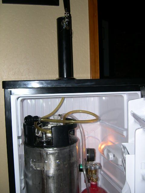

I made my own, out of a small apartment/dorm type fridge. I homebrew; it fits the 5 gallon Cornelius cylinders perfect. I can fit a 5 gallon mini keg from our local brewery too. I just kegged 10 gallons of porter a few minutes ago.

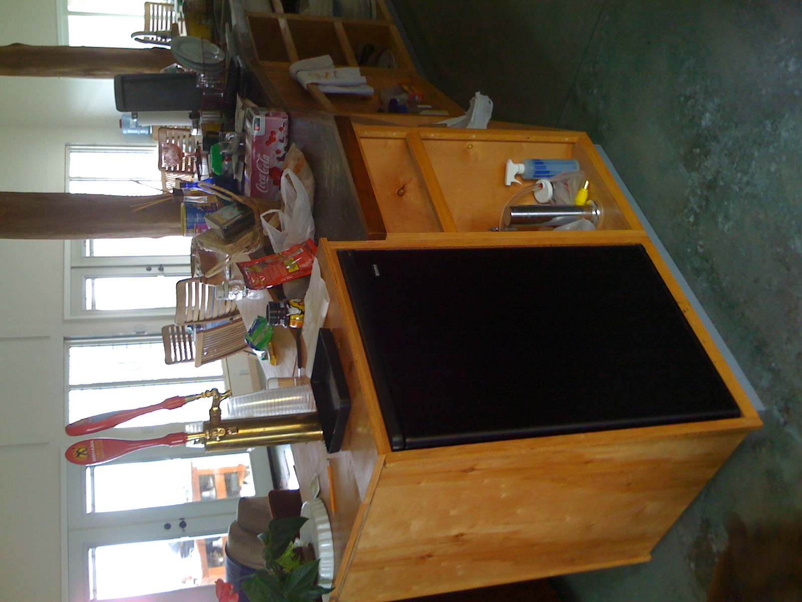

I'd highly recommend it. I have the model sold by Sears. Changed it over to a double faucet and try to keep 2 of the 5 gal kegs going from our local Mehana Brewery. I say "try" because the darn things just keep running out :D
David
Maybe sometime I can load 'em straight

I have a small frig in the basement that I converted into a kegerator for my homebrew cornie's. I do have domestic tappers but don't really buy domestic kegs. Usually just my own brew. If you're using a keg at all get setup for CO2. Then if you tap a keg and find that you can't drink it all (which happens alot) you can keep the rest just as fresh and ready to go as the day you bought it to enjoy later.

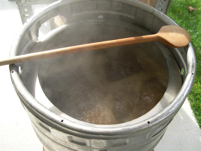

Cooking, fermenting, and ready to drink from the home made mini-kegerator.
One is the grains mashing. One is cooking in a converted stainless beer keg. Last is the beer ready to dispense.
