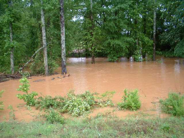

Here is my situation. I am working on some property that I am buying from my grandmother. I hope to build a house there next year. The property has a creek that runs year round and about once a year or two we get that rare rain that get the creek way up. The creek has a high bank on one side, about 3 feet higher than normal level. There is one spot that the bank is only 6" to a foot and that is where the water comes spilling over. I want to fix the low spot and I want to fix it good. The spot is about 15-20 wide. I have consider stacking quik crete and driving rebar through the bags and then backfilling on the dry side with dirt. Any suggestions. I am attaching a picture of where my driveway will be and what it looked like back in May when we had about 3 hard days of rain. At this time I only added about 6" of dirt to my future driveway.

Sounds like what you're considering will work. You'll need lots of Quikcrete and lots of dirt. Make sure you get it at least as high as the neighboring banks. I would also double the wall of Quikcrete to ensure that the water won't seep through it and undermine the wall.
I think a more permanent solution would be to drive sheet pilings along the bank and then backfill against them. The drawback to this solution is the cost, but it may be worth it in the long run.
/ Keeping the water back #3
Or you can dig a big pond there so when the rain comes it fills up the pond instead of your yard /forums/images/graemlins/grin.gif
Otherwise, build up the bank with dirt and rocks and plant it to tie it all together. This will help keep it from overflowing. We have a small creek that runs year round going thru our property. It has never been a problem because it has a bank built up on both sides of the creek. Every spring it comes up to about a foot from the top of the banks but never goes over or washes the banks away.
/ Keeping the water back #4
The seasonal rivers in Southern California are "riprapped" Steel posts are driven into the ground ever 8 or 10', and wired together like fencing. The fence is double, with about 3 or 4' between them. The interior of the fence is filled with rocks about the size of basketballs, etc. Native earth is backfilled to the rip rap. Works real good in the rainy season, when dry creek beds become raging torrents.

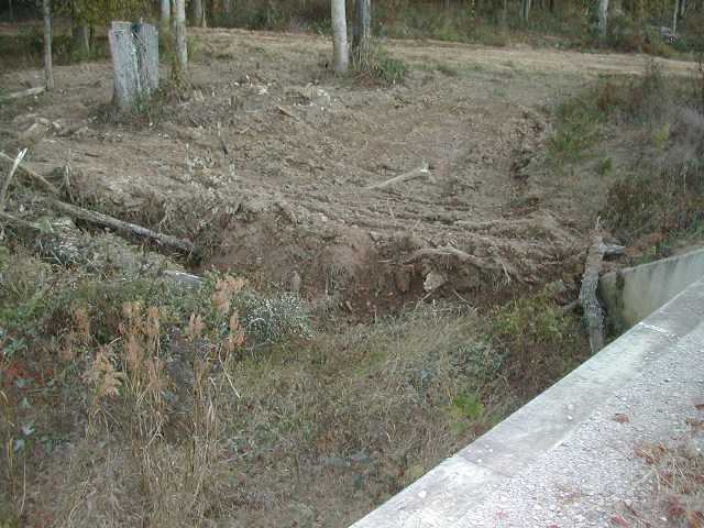

This is what it looks like after about 30 minutes of grading, as seen from the bridge at the road. You can see the future driveway in the back ground.

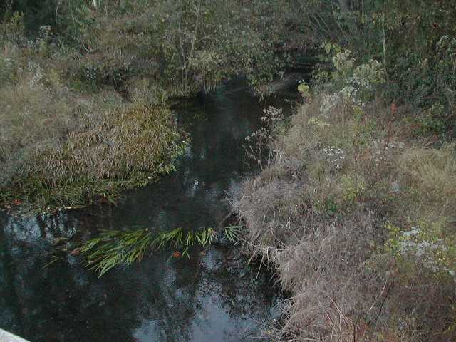

And the trouble maker. I would rather have to fix the problem than give up the creek.

Good point. The county came in a few years ago and replaced the old bridge and did a little digging out beside it. I think their intention was to let the water from the ditch go into the creek. Just the opposite is happening now.

I'm just fixing what the county messed up! That and there is an old mill race (big deep ditch) that supplied water to an old grist mill that has not operated since the 1930's. The mill had collapsed in a couple of areas and it would take on water during heavy rains and distribute it where ever.
