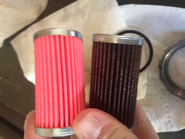

Thanks for the review. I need to pick one up. Earlier this year I had picked up a contaminated batch of diesel...probably went to the station right after the tanker filled up the storage tanks or something. Here is a pic of the old filter next to the new.
