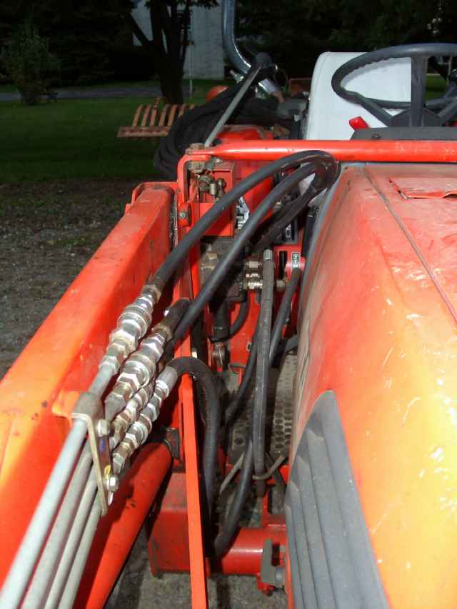

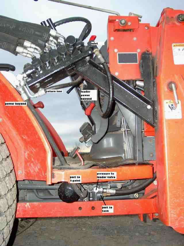

Jim,
I am not sure how your Koyker loader looks , but I did remount my Kubota loader valve to stay on the tractor when I added my aux. valve, I welded a piece of angle onto the lower mount & the valve mount plate, then added quick disconnects to the hard lines on the loader arm. I do have to run the plow off of the aux. valve though because of the 3-way on the loader dump circuit. Right now I actually have the plow on with the loader still on because of a broken fitting on the lift cylinder, talk about confusing, lift plow with loader up/down & angle with the aux. valve.
