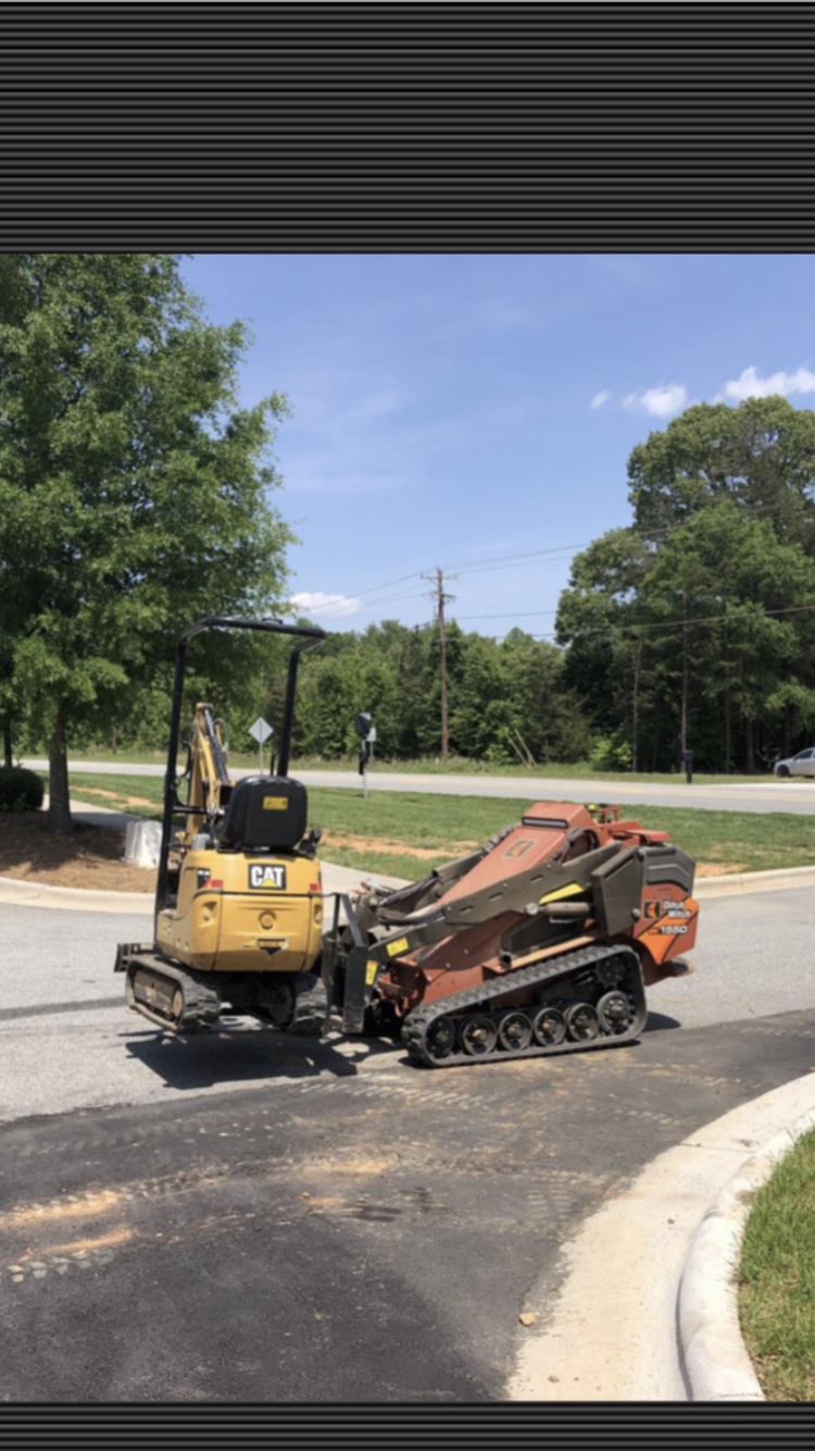

I think you’ll find the wheeled model junk but the tracks are a game changer. The worst part about a skid is tearing up the ground but one of those mini skids will work circles around a B tractor. The other main con with a skid is they move slow. Driving any distance isn’t their strong point.
