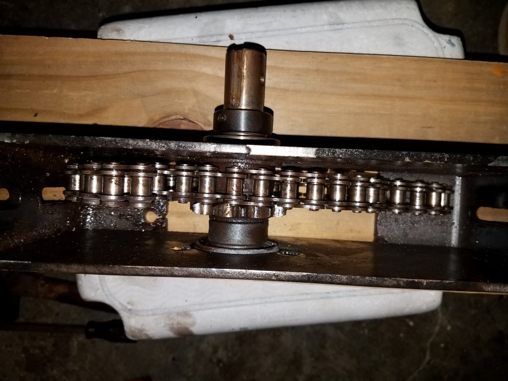

Found problem, small sprocket inside gear reduction box spins freely after the two set screws are removed. Not good. When I spin the shaft I can see what remains of the 1/4" key that sits in the shaft and holds the small sprocket in place. I have the gear reduction box out and the only thing that remains is the two outer bearings and the sprocket. I can't figure out how to get the shaft to come out. There is one good size piece of the key in there and I am guessing the clunk I was hearing was the shaft spinning and catching and then torquing the fan shear so much it would break. Blower fan is solid, minimal play at least not enough to hit the wall.
Any suggestions on how to get shaft out of gear reduction box? All bolts and set screws are out.

   / Keep breaking fan shear bolts, every minute or so #9
It was probably pressed in plus if the gear free spun the shaft could be scored.
I'd try a press if you had one, otherwise a large vice could do the trick as a DIY press.
Can't see from the photo but if U can see the other end of the shaft you could also drive it out using a narrower rod as a drift punch.

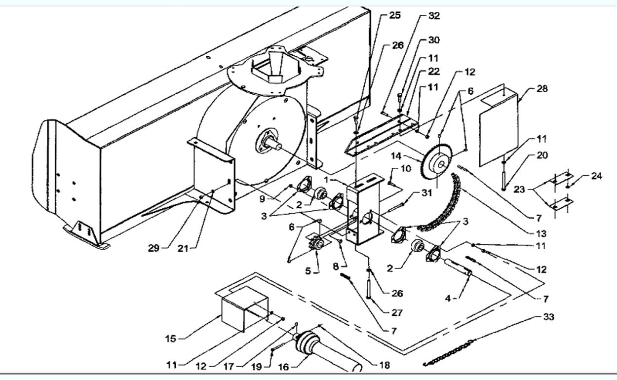

   / Keep breaking fan shear bolts, every minute or so #10
Maybe the attachment will help some.
