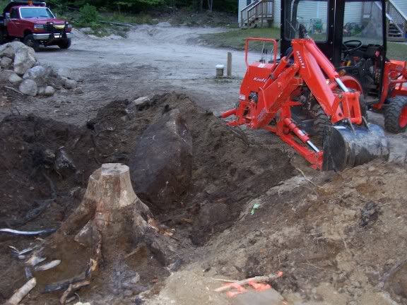

I have the KB2365 on my CK20HST and can't say enough about it. It is amazingly powerful and easy to take on/off. If you don't have the tractor firmly planted and hooked to something like a tree or truck, then it will pull it along like a ragdoll. I have the 16" bucket and wouldn't want any other size, it seems to be the perfect match for it.
I have dug up some monster stumps with it too!
Stump 1 Stump 2 Stump 3
