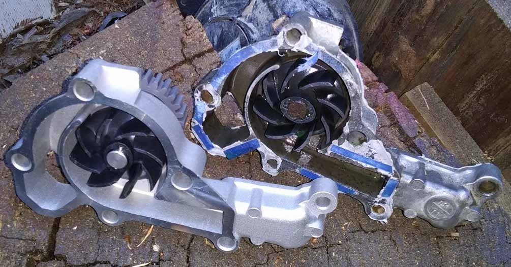

Does anybody know even the Kawasaki part number for the impeller shaft in this FD731V Kawasaki motor?
I can't think of any maker that currently sells all the internal parts to a water pump. Even getting them apart to replace a seal, shaft, or bearing is often not possible without damage.
This is an aftermarket pump I put in an FD620 on a Gator. It was not expensive, tho not OEM, either. I am not thrilled by Kawasaki's extensive use of plastic on the drive gear, impeller, and cam gear (!). Might be the same as yours.

Thank you for the replies so far.
FD731V has the impeller shaft built into the engine casing and the pump components (3 seals and the impeller and impeller bolt) go onto the captive impeller shaft.
All the seals and impeller are still available from John Deere, but they don't even show the impeller shaft on any of their parts diagrams, hence being unable to order one.
The FD620 pump won't work unfortunately.
The mating housing is also pitted, but this is also readily available new. It doesn't make sense that there is a listing for every single water pump component except for the impeller shaft. It's not discontinued; it just doesn't show up on any parts diagrams anywhere and I'm stumped...
