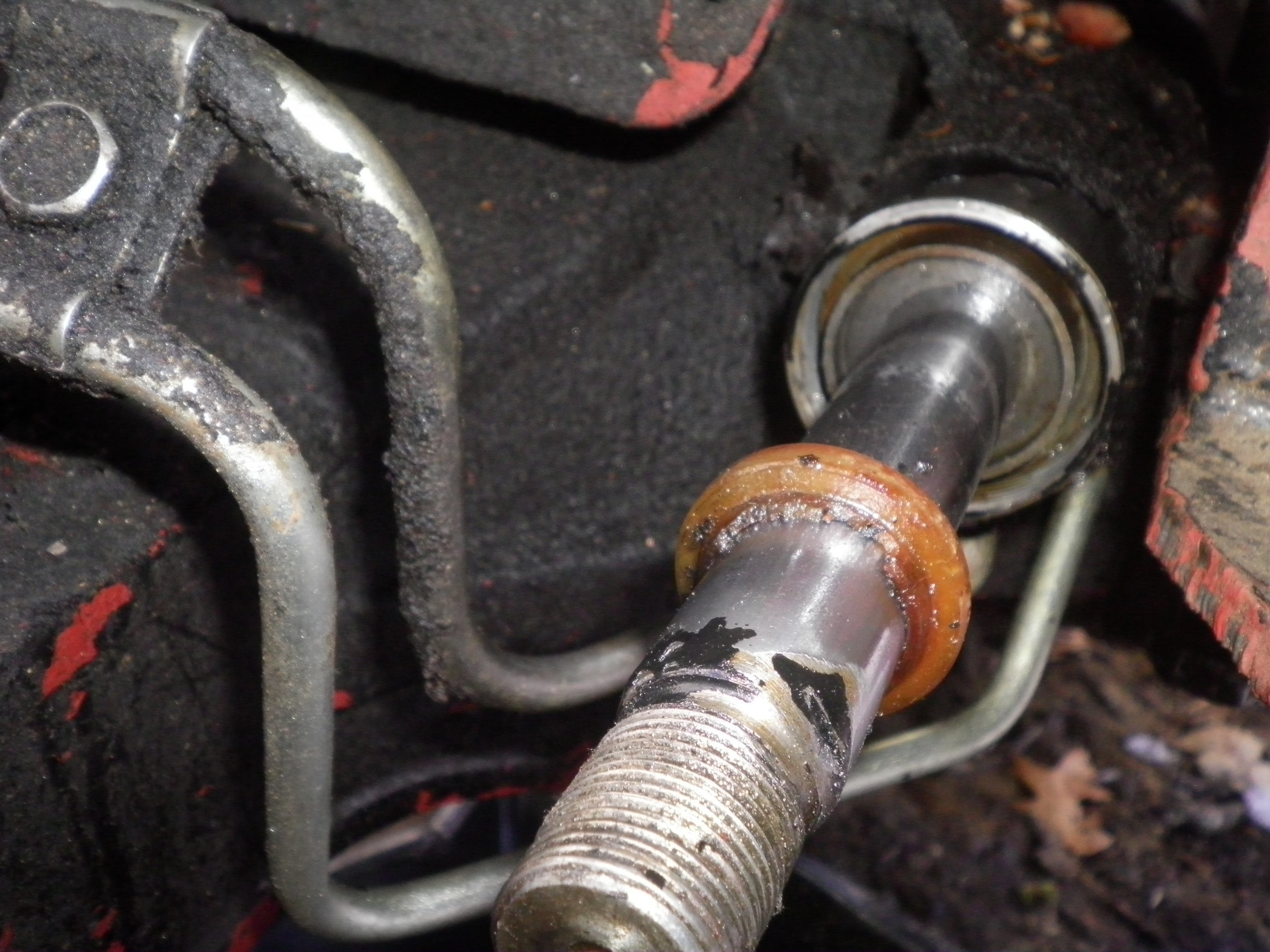

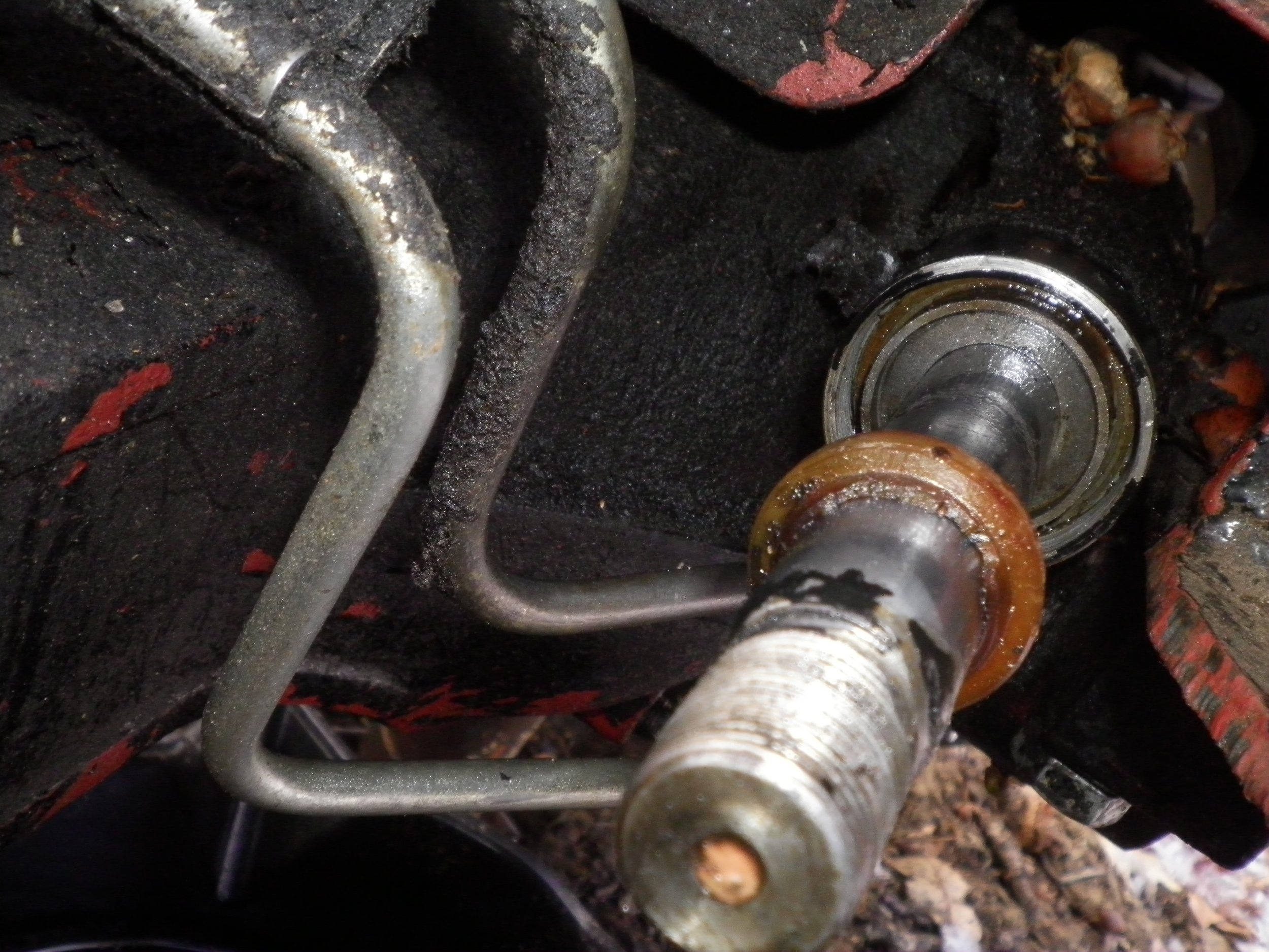

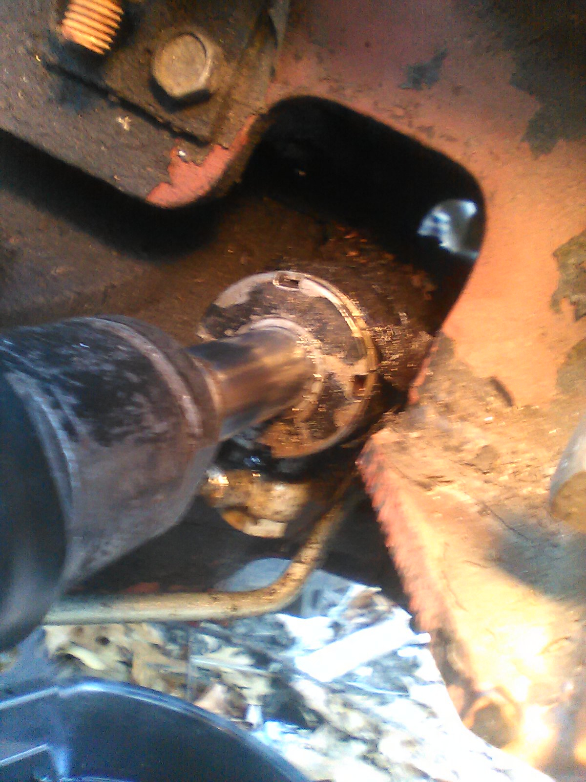

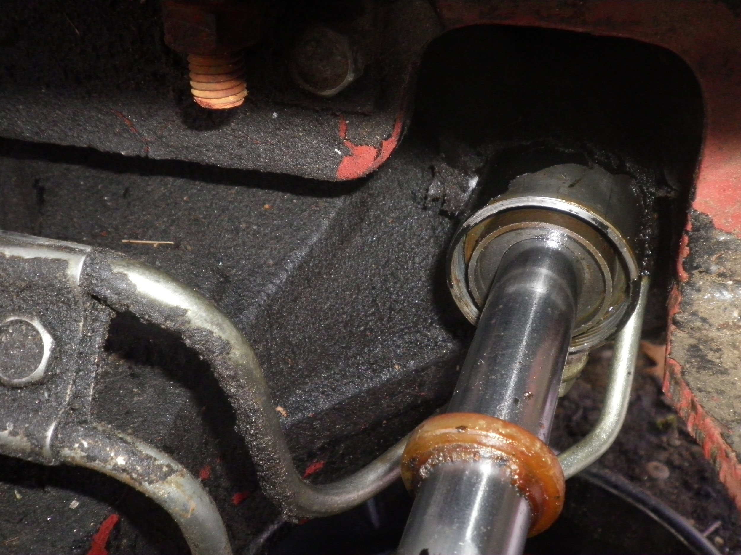

I have a Kama TS254C tractor, and the steering cylinder is leaking on both ends. ( It uses a double ended cylinder, the rod comes out of both ends ). There are threaded end caps. I removed the end caps, and there is an inner cap, that I assume has an o-ring to seal the rod.
I can't figure out how to remove this inner end cap. I tried to push it out by pushing on the rod from the other side, I tried to push it in to see if it is hiding a snap ring, I do not see any wire on the outside that could be holding it in. I also removed the banjo bolt where the line attaches to see if that was somehow holding it in, and looked in to the port to see if there was any kind of retainer accessible through the port.
I took apart both ends, and they are identical.
Does anyone have any suggestion on how this thing comes apart?

Usually you can use the rod as a slide hammer. Just keep sliding the rod in and then pull it out quickly. The piston will eventually drive the gland out. Repeat on the other side.
   / Kama TS254 Steering cylinder
Thanks, that worked.
