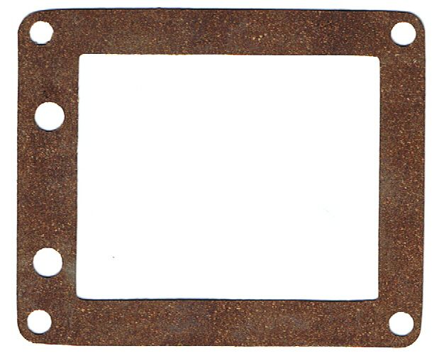

/ Kama Significant Oil Leak #5
Why would you buy bulk gasket material and make gaskets when they are readly avaliable at multiple sources ??? That's crazy !!!!!!!!
Because - in my 10 years of Chinese tractor experience - their cheap cork gaskets simply suck !! Damned things disintegrate in place. Plus - those that haven't already decomposed - tear like tissue paper when wet. I just got fed up replacing gaskets every bloody time I had to remove a cover or inspection plate.
So based upon observed p!$$-poor performance, I now steadfastly refuse to buy'em. I get comparatively inexpensive 18" rolls of bulk gasket material from NAPA. It may take a little more time to hand cut a gasket. But believe me - one competently cut gasket from the appropriate bulk material will outlast half a dozen of those lousy Chinese cork things.
//greg//
/ Kama Significant Oil Leak #7
None of the gaskets he will need to do this job are cork ?,the OEM are paper gaskets.
Jeez that's even worse. The OE gaskets I've obtained in the past at least look like cork. Maybe just sawdust and glue, who knows. Anyway - paper or cork - they're crap. Having said that, I enjoy the luxury of time (retired). Folks in a hurry to git-er-done are likely to be more amenable to pre-cut gaskets of any quality.
I'm not sure if you're interpreting my words as critical of your response or what. I have no problem with you retailing any kind of anything to anybody. After all, caveat emptor. My opening response merely offered advice to a fellow KAMA/TaiShan owner, based upon personal experience and opinion.But until RedRider identifies his engine, neither of us have any business speculating how many of what kind of gaskets he's going to have to deal with.
//greg//
