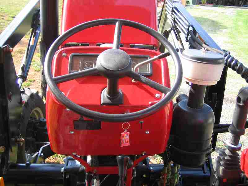

Delivered to my door at 7AM. The driver called Sunday night when he made it into NC. Said he could deliver any time. 7AM was perfect for me to receive it and still make it to work. Overall its an impressive machine with the features that count. It has the Koyker 195 loader. I didn't do much on it yet. Checked bolts for tightness, did the 15 minute engine run-in described in the book - 5 min idle, 5 min medium speed, 5 min wide open all in neutral. The engine starts and runs good. Max RPM is a little low - maybe I need to adjust the valves right away? The PTO gears are noisy unless I have the clutch in all the way and there is a good bit of gear noise in reverse. Is all that gear noise normal at 3 hrs?

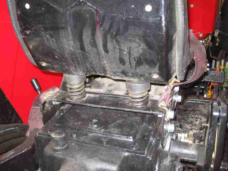

It didn't come with a seatbelt or PTO shield. The dealer said the factory doesn't include them. I guess they are not familiar with the principal of CYA. I added a seat belt from the back seat of a junker I happen to have. I might buy a nice new one if the one I am watching on ebay doesn't get bid up.

I also have a 554 and am very happy with it. My air cleaner is not located to side like yours. Who did you buy it through?

That's a great tractor you got there. I have the 2005 model...same engine. Got everything on mine including the rear remotes, seat belts but no PTO shield?? Is that air cleaner the oil bath type? Mine is not.
From what I've heard from other Kama owners, the gear grind when new is pretty common. Mine did the same. When I did the first lubrication changeover, the tranny and gears shifted totally different...they worked great. As far as the rpms, after I adjusted the valve lash, I made more than the rated rpms...wish I would have checked them sooner because it was so easy to do. Here's a link to how I did it, if you're interested and many helpful comments.

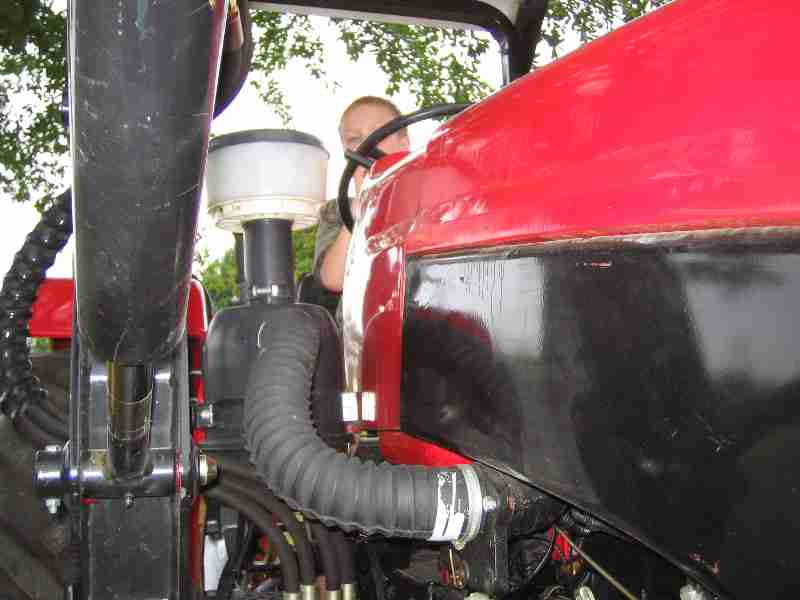

Thanks guys for the informative replies.
PSJ12: I got it from Walnut Knoll Farms & Supply in Flemingsburg, KY. He keeps a few tractors on Ebay. It was $15,000 delivered. The oil bath air cleaner was re-positioned by the dealer. According to his employee who delivered it, the normal position interfered with the loader. The attached picture shows the flex hose coming from the normal mount.
